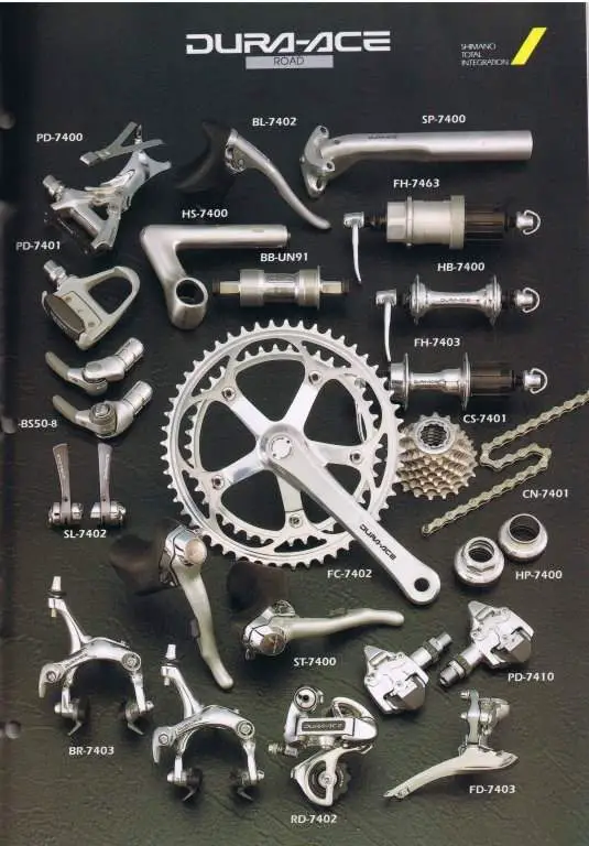

I know I'm not a regular poster here... But I know this is probably the place I can find an answer.
I've been doing some research, and found that the barend shifters for the 7410 group are pretty rare... Or don't exist?
The only model number I can find is in a Shimano catalog, but it's the Ultegra model (SL BS50 :cool:... Which I've read has a different shift ratio to the RD 7402 ...
They also appear to have a sticker saying they are not compatible?
So my question is, have any of you used this group for a Time Trail build with barend shifters, and if so which ones did you use? Or is there a work around?
If you have a 7402 rear mech, then shimano 9 speed shifters pull the correct amount of cable to index it on an 8 speed cassette.
7410 wasn't really a group as such - the whole group started out as 7400, but various parts got upgraded and the numbers changed (brake calipers went double pivot, rear mechs went from 7 to 8 speed, etc). As you can see in the scan you posted, depending on the part it's either 7400, 7401, 7402, 7403 or 7410,but they all form a single group.

Foz is correct - the SL-BS77 shifter from the 9-speed group pulls the right amount of cable per click to shift an 8-speed Dura-Ace system.
There was an 8-speed Dura-Ace bar-end shifter though, and it was indeed called the SL-SB50-8:
http://www.ebay.com/itm/291836723501
http://i.ebayimg.com/images/g/iLIAAOSw~ ... -l1600.jpg
http://www.cadre.org/bike_stuff/Shimano ... I00003.jpg
I have one on my desk as I type this, and the little sticker reads "Compatible with Dura-Ace rear derailleur". The plastic lever cover has "SL-BS50" moulded into it - no "8" in evidence. The date code sticker is "VB", i.e. February 1997.
The 8-speed Ultegra unit was the SL-BS64. The plain SL-BS50 was 7-speed Ultegra.
The Dura Ace 7700 9-speed bar-end shifter is still available as a new part
It shifts Dura Ace 8-speed
I meant, of course, the SL-BS50-8 !
I am totally lost here. The Ebay shifters are indeed SL-BS50-8 and it states Dura Ace... But all the other ones that I can find that come under the same model number state they are Ultegra?
I think you can trust Shimano's documentation. It's true that a couple of internet shops seem to be listing BS50-8 shifters as Ultegra, but that's an error. ADFC has it right:
http://www.fa-technik.adfc.de/Herstelle ... no/SL.html
I'm thinking the 9 speed Dura Ace shifter is the easier option.
They're available new, and they work perfectly, as PANZR says.
