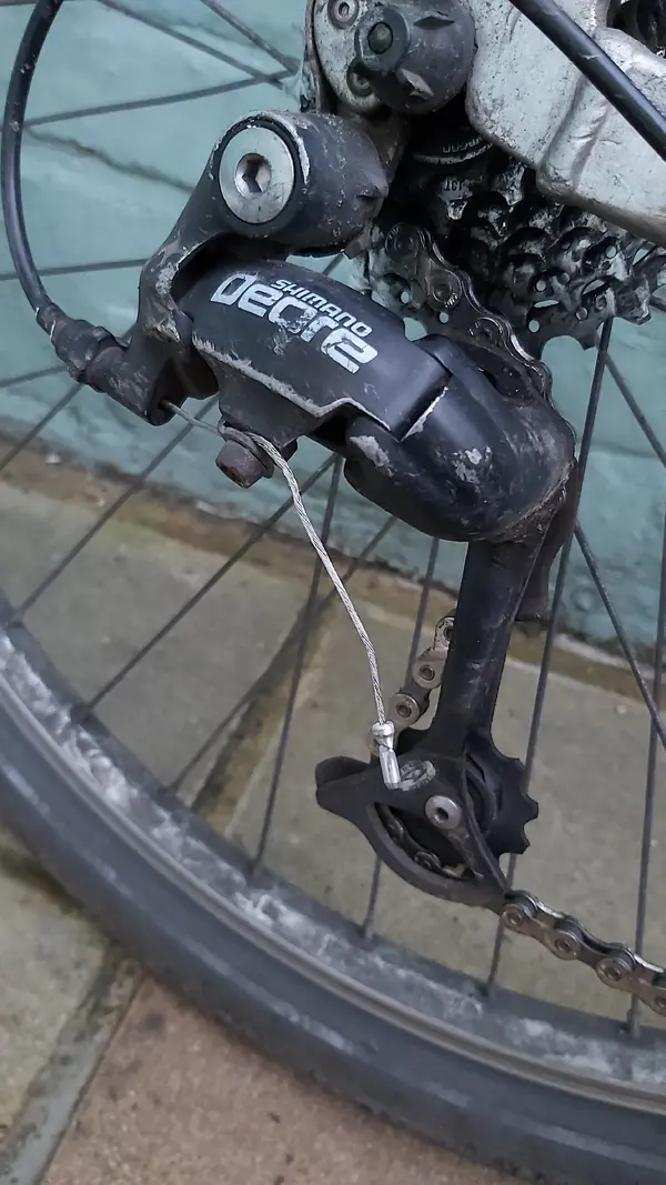

The XT M770 mechs were the last of the 9 speed XT mechs before the M780 series introduced 'Dyna-Sys' 10 speed with a different pull ratio and double pantograph mech configuration.I run 'modern' XT 770ish (2010 era Shadow mechs)
You can still get M770 mechs as well as the Deore M590/591/592 mechs which are all 9 speed mechs and therefore backwards compatible with 6, 7 and 8 speed shifters and cassettes.
You can also use 9 speed mechs with all the Shimano 10 speed road brifters because they use the same cable pull ratios.
This is good for using MTB mechs on gravel bikes for example, although the older ten speed road shifters aren't that great due to the internal cable routing. But I digress.
This is true up until the latest Tiagra R4700 10 speed shifters which use much improved the 11 speed pull ratio.
This opens the possibility of using any 6, 7, 8, 9 or 10 speed road mechs (except Tiagra R4700) on older road and MTBs.
Basically, Shimano stuck with the same 2:1 pull ratio and double panto arrangement on almost all their rear mechs and shifters up until the introduction of 10 speed for mountain bikes and 11 speed for road bikes.
There are some exceptions on one of the earlier Dura Ace groupsets but I can't remember exactly which one.
