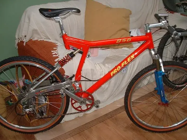

Lx cranks
I've got some Lx ones. Cranks only £20 posted. Cranks and red middleburn 42 outer and steel bolts £32 posted. They are currently on my Proflex but don't look right as they are too new so will be replacing them with older XT ones.
