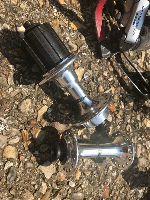

Unfortunately not all Shimano hubs allow just any old Shimano freehub. Some hubs have a lip on the body that fouls certain freehubs.
I would suggest buying the whole hub rather than just the freehub body as hubs are often far cheaper and have other useful parts such as cones and bearings and washer etc.
I would look at the Deore M475 hub as a donor for the freehub - this went straight on to an XT hub without issues whereas others had fouled the XT hub with its 'lip'
If your 600 Ultegra hub is anything like the XT, you may encounter the same problem.
Or not!
Note the 'lip' around the hub body
Looking further into it, I think you should be ok with just about any freehub body but I'd still advise on the whole hub in case you have differences in bearing covers.
Heres why I had issues replacing my XT 8spd hub a while ago - ignore the spacer on the freehub body itself, the space where the body went into the hub was slightly too narrow for the many freehub bodies I had access to
