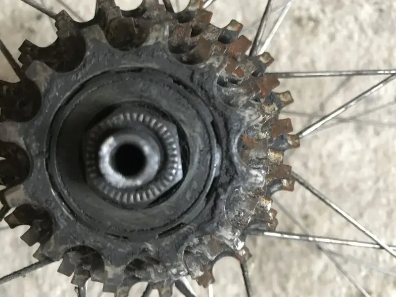

Hi, I have an 88-89 Raleigh Road Ace with a shimano 600 groupset. Could anyone tell me does this have a cassette or a freewheel? I can't see how to get a removal tool into it. Any advice please?
Pound to a penny it has a casette, unless it's something odd like a helicomatic lol. Any pictures?
Resize the image on your computer change the largest pixel count on the height and length to 1050 and and save then upload as normal as you see photof**ket is no longer an option.
Thats a Uniglide cassette. Last cog screws onto the threaded part of the cassette body and looking at that picture, it will just be an arse to get off in a hurry.

The easiest thing to do is take the axle out, get a long 10mm allen key and take the whole Uniglide bit off including the cassette and fit a standard shimano 7 or 8 cassette body back on. Then you can fit a 7 or 8spd cassette with all the benefits.
