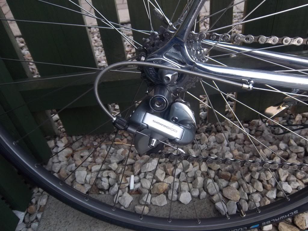

I have these hubs build in wheels on my Van Tuyl, mine are super quiet.
I posted on a thread about bike bells etc and this it the bike that a pedestrian did not hear approaching.
Richard
Don't take this the wrong way Richard , but Ilike your rear end :shock: :lol:
What outer gear cables are they ? Like them 8)
Mike
My rear is mine!! (most of the time!)
The outer should be Shimano, I will check the build thread and see if i recorded it but I am betting Shimano.
Richard
