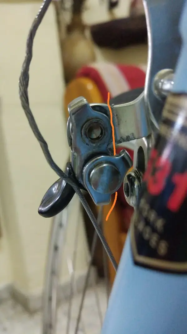

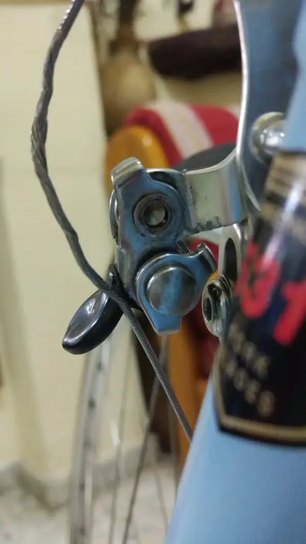

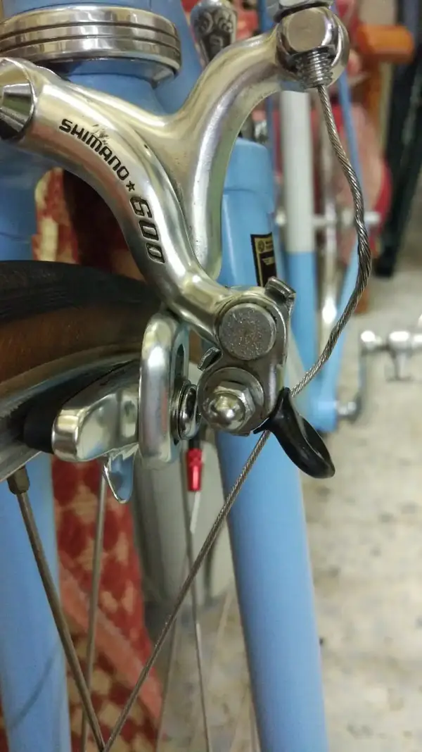

Im trying to install this shimano 600 brake calipers and im really struggling setting the wire in its place. it alwais get loose from the caliper. Should it be like in the picture? in some other way?

I have two sets of Shimano 600 (Arabesque and the latter mid 80's version) and I believe they both have a hole in the center of the bolt that the brake cable should slide into before tightening. Take a closer look at the bolt and move it around a bit to see if the hole moves into view.
Spin the rear washer round until the two tabs lock either side of the caliper... I think, been a long time lol
xzaar":1qvzd8b5 said:
You are f***ing right mate. I have waste all day fighting with it. Thanks
