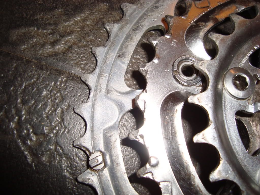

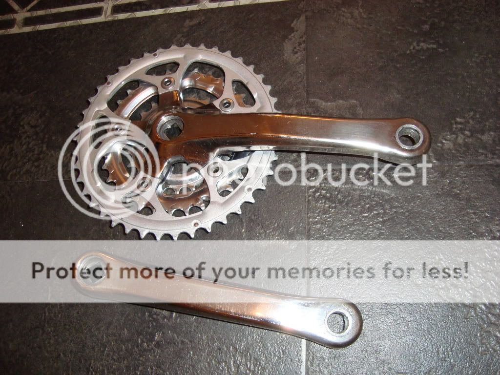

Here are the pics, i had to feed the offspring!!
Flash makes it look rougher than it really is!
Here lies the problem though: Some of the teeth are missing altogether!
So, from what you have said I ought to be looking for a "new" set of cranks. Suggestions for a '96 Klein Pulse? Im guessing something XT would not be amiss?
