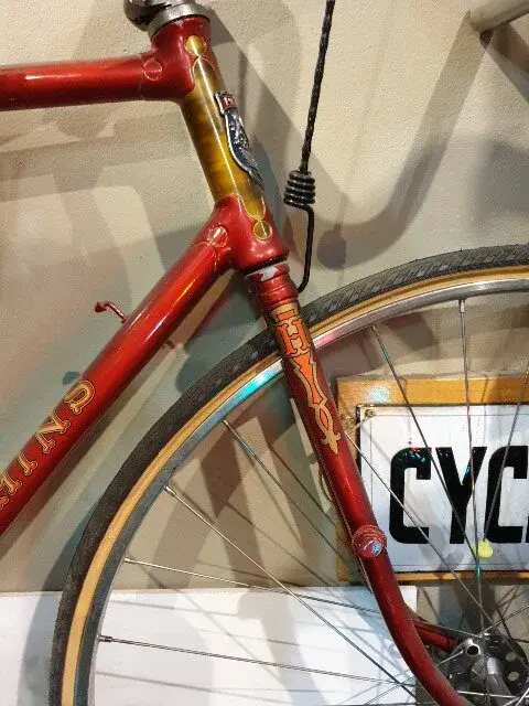

I'm after a pair of nice quality, good condition steel brake calipers, for my curly. I've nearly managed to make a complete lightweight bike without any aluminium alloy, but the final couple of parts are proving difficult. 20241008_172751.webp
It's true that this was a short drop option, but the curly's paintwork is too good to fit resilion - and almost all the parts are in near new cosmetic condition🙄

So it's been a good while but now I've finally been able to find some brakes you might like. No sets as yet though as I thought I should show you what I've managed to find and if you like the condition then I can carry on searching for the matching brakes. The first one for your consideration is a Monitor Sheerline which is roughly in condition I recalled it would be in my last message, that being pretty tatty with quite a bit of chrome flaking, although the chrome that remains is still quite shiny. Overall, it's probably not up to what you require for your bike but very likely the other one (I bought them as a pair) will be in similar condition so if you're actually keen on the one then the other will satisfy you too. The second brake I found is a Follis Bebo Sport and this is quite a contrast to the Monitor as it's in pretty much new-looking condition and I suspect may even be NOS which is quite unusual for brakes from this era (I suspect 40s but possibly 50s/60s). There's no wear I can see, but on the downside the brake isn't as exotic a design as the Monitor and also I'm not entirely sure I have the rear brake to match it as I can only remember having alloy Follis brakes, not their steel ones. Anyway, I'm still sure I have the Grip-It brakes I mentioned previously (and these were definitely a set) so if you're interested in the Follis then I'd also try to search out the Grip-It brakes seeing as I recall they're very similar (plain) designs, so I'd guess you'd be equally interested in both.
You're out of luck, I'm afraid. Neither of the brakes have as shallow a drop as 47mm. I had thought the Monitor one might manage it, as it's the shallowest 40s/50s brake I've come across, but it wasn't to be. TBH the drop is one I believe to be common for modern bikes, and I'd have thought that really vintage ones (like yours) that were designed for shallow drop brakes would still have a larger drop fork design that what the modern forks have. Perhaps due to the (possibly wrong) idea I have that even purist racing bikes back then had wider/fatter tyres, seeing as this seems to be necessitated due to the tyres not being designed to be pumped up to 100+psi tyre pressures, so the tyres were bigger to compensate for this (ie they'd prevent punctures seeing as running too skinny a tyre not pumped up hard enough increases the chances of 'snake bite' punctures). Anyway, as you say, the deeper drop brakes were pretty ubiquitous back then, but if bikes like yours weren't a rare design then there should still be quite a few brakes around that are shallow enough to be compatible with them. But I'm not sure I'll have any. From memory, the Grip-It brakes I have are very similar to the Follis brake above, so I suspect the drop would also be similar, which is unfortunately deeper than the Monitor that is significantly deeper than the 47mm you need. But I can still look for them if you feel there's a chance of success.
It seems like the alloy caliper preceeded the close clearance fork and brake bridge, and steel never followed up because it found itself at the opposite end of the market.
Standard shallow drop application was resilion, mounted on the stays and blades.
I've got 27x 1&1/8 tyres, could probably fit 1&1/4, maybe not with Guards🤣
I don't think anyone expected the British to buy a bike without clearance for Guards in 1950 🤔
