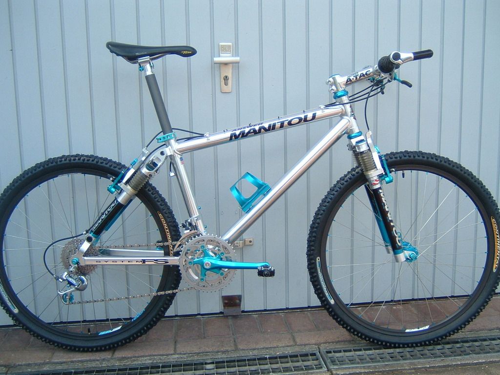

I agree, long travel forks are no good to me as I'll be doing mostly XC on the bike, no sustained downhill stuff. My ideal would be a Manitou 2 or 3 fork - I had Manitou 2 forks on my original Cone and Manitou 3 on the Manitou FS I built in the mid-90s (photo below). Perhaps not the best but certainly period correct and good enough for what I need.
That Manitou is stunning ;) Hope it survived without cracks.

The Manitou FS is long gone I'm afraid - sold back in 2005 if I remember correctly. You're right, the frame tubes were on the thin side so it wouldn't surprise me if it'd given up the ghost by now. It was an awesome ride though.
