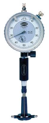

you cannot measure a bore with a vernier caliper! you need to use a bore gauge,a completely different instrument.the top of a seattube will be squashed in,the only bit you can try and measure with a vernier.where the seattube meets the top tube is the true size,this is why you need a bore gauge to reach further in.
