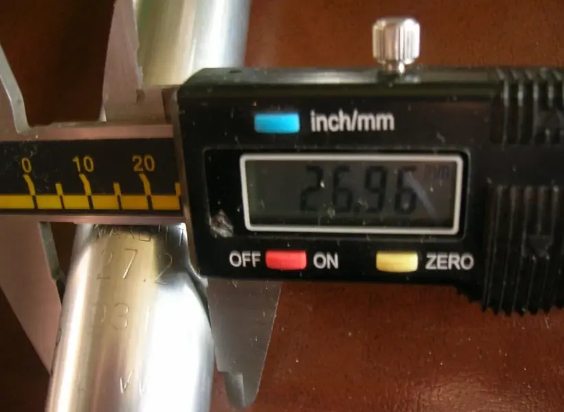

An issue that is compounding this debate (now and previously) is the fact that a seat post may not be the claimed size. Here is my digital caliper reading 26.96 on a post stamped with 27.2.
