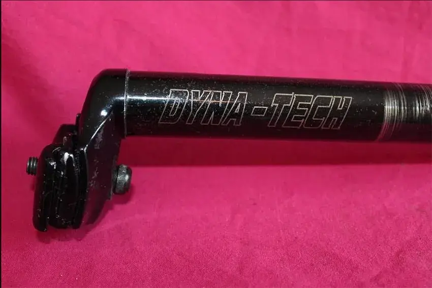

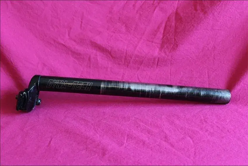

I recently picked up this seatpost for a new build but I would like to spruce it up a bit and if possible make it look new.
Any ideas on how I can do that?
I thought I could get it re anodised but Rampage isn't doing that anymore and as its probably steel it wouldn't work.
Suggestions welcome.

Anodizing is a conversion coating on Aluminium, if you have steel base material then you almost certainly have a chemical coating
Assuming it is steel (heavy and magnetic) things like black chrome plating (which this looks like) can be redone, no idea about cost though sorry - and current coating would have to come off. Not sure if you could mask a new logo when it was done
If it was mine I would carefully strip the steel tube and hope the logo was still visible
Thats brilliant, thank you.
I'll see if there is somebody close to me that can help.
are you sure it is steel? - be pretty heavy
if tube is steel my guess would be the head is forged aluminium, which will complicate any attempt at re coating - steel and aluminium are completely different when it comes to coating, unless you go for paint which isn't really an option for a seat tube
Just checked. The post is steel but the head is aluminium :oops:
How would they have made them originally?
I think they will be a shrunk fit i.e. heat - expand the steel and or chill - shrink the Aluminium then push together maybe with Loctite or similar.
bullpup could be right, potentially the aluminium could have been cast/forged directly on the end of the steel tube too
how they coated both to be black I don't know - but I am sure someone here will
Thanks for the help guys.
I have found a place near me who does the plating so I have contacted them for some advise. Hopefully they can help.
If not I'll have to think of something else or just leave it...
i know you are a perfectionist so might go against the grain, but an obvious alternative would be to find a new black post and get the Dyna Tech logo applied, etched or transfer etc
