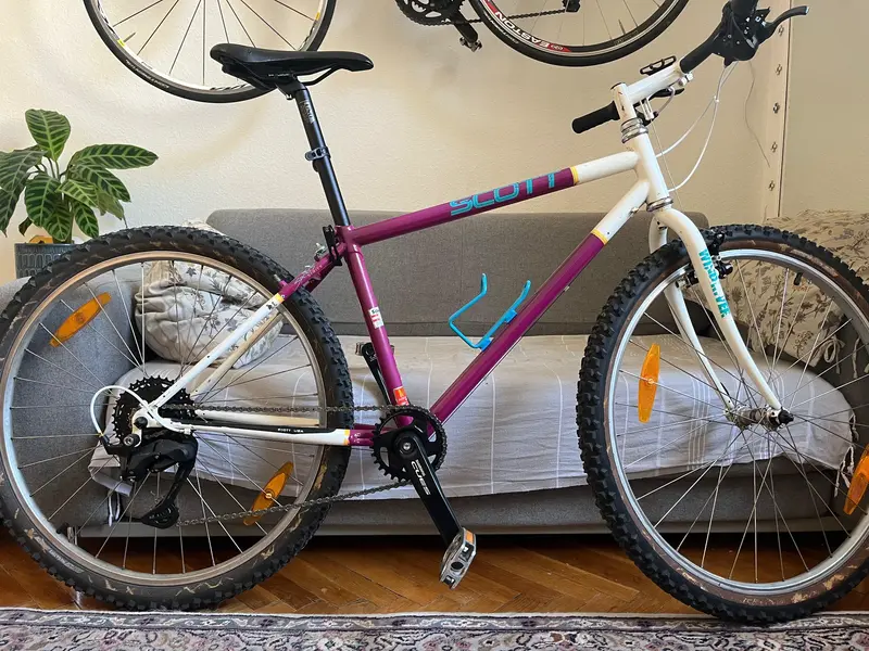

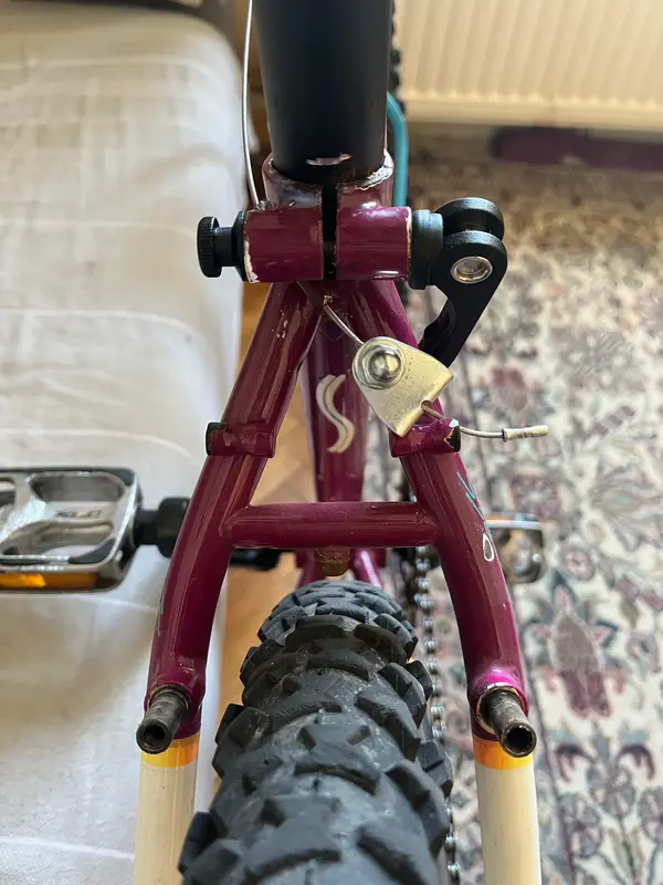

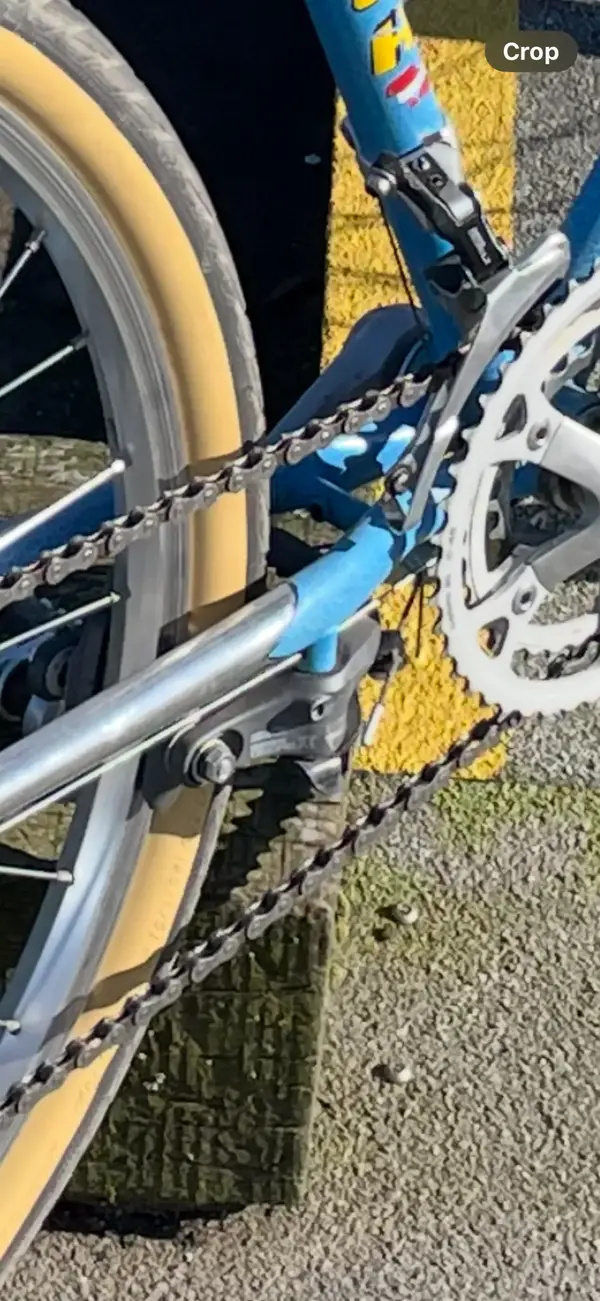

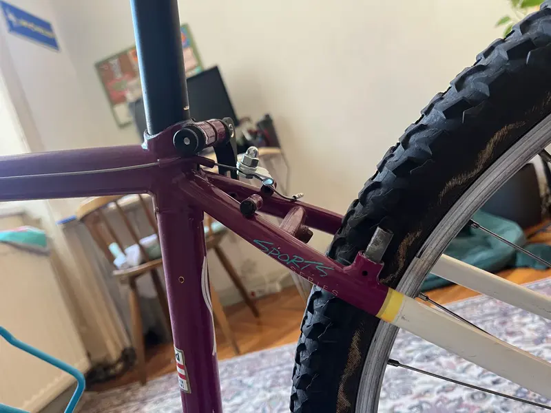

Hi all,
I'm building this Scott Windriver 1990 and having some problems with finding a rear brake. As you can see I got the model with the ubrake mounts. Since the frame is quite small, the distance between the mount and the cable duct which is part of the frame is only about 10cm. I assume I'll need a ubrake where the arms are especially flat and wide? would the Shimano Exage Mountain BR M452 be an option? What other options are there?

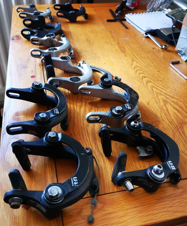

I think they're all about the same dimension, I have an m731 XT brake on one of mine and there's less room for the cable than you have.
