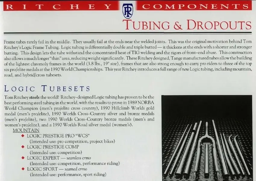

Depends which Ritchey Logic tubing they are using
There was the Ritchey Logic tubing (modified version of one of the normal Tange tubing)
Ritchey Logic Prestige based on the Tange Prestige variants (may may not have use super/ultra/otherone-light tubing or just normal Prestige) but with refinements
Then there was Ritchey Logic Prestige WCS. I guess their all out tubing using the best of whatever.
Summit like that, but specifics go as far as shorter butting, not much else given by them that I've seen.

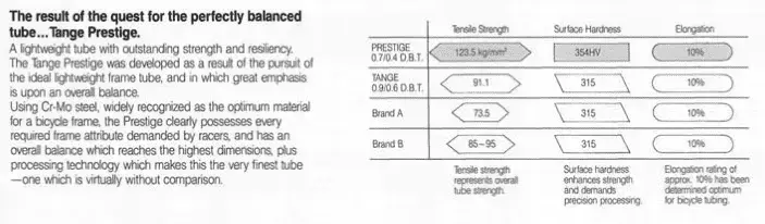

Tange Ultimate Ultralight (they're all 'Prestige') would appear to be thinner in the middle (0.5mm) and beefier at the butt joints (0.9mm) - as opposed to 0.8mm unbutted for Superlight. I'd guess that the Ritchey stuff is the Ultralight in all but name.
My web-based understanding is that Ritchey had custom(er) revised specifications for the same Tange Prestige drawn tubing which shortened the butt ends a tad to shave a few grammes. Whether this affected the ride quality is up to the pilot I guess, but its greatest effect must surely to have increased the cost, especially if it was shipped to Ritchey then on to the frame manufacturer, along with the USP kudos of course.
My Kona HOT has an Ultimate Ultrastrong downtube and top tube (all that was available) as it has the ribbed internal and external butted sections (0.7mm walling/1.0mm butts).

Interesting - the down tube is clearly Ultrastrong but not the seat tube? I doubt one could call your bike 'mass/factory made' in the sense that there won't be many made at all! Someone at SWATCH must have known what they were doing speccing the tubing - I wonder what the sale cost was when complete?
It belongs to xerxes not me, I've just taken an interest in that one too. I noticed the design is similar and I'd guess they came out the same factory as Marin's. If both had a desireable name on the downtube they'd probably sell for multiple times more! But it means you've got a high-end frame for peanuts :)
You can see there were many different options for each tube so likely no two Ultimate frames are the same or better/worse than another:

My take it the Ultimate diamond sticker gained kudos, so they used it branded under Tange, but for the normal none prestige tubing they went for Ritchey Logic version (without the Prestige moniker) because it sounded better.... built from it's Logic Prestige range topic heritage. At some point Ritchey switched tube supplier late 90's ?
