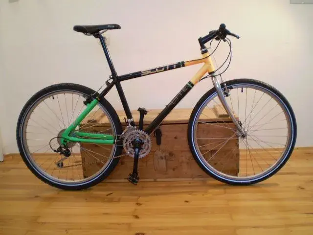

A very nice set of what seems to be Sugino chain rings arrived from the UK.
Thanks my man Charlie.
Attaching chain rings and fitting the cranks was nice and easy. After that i put the old, clean and patiently waiting chain back on the bike and adjusted the rear mech and that's it as far as nice and easy things went.
Took me about an hour or so to fiddle out what the correct position of the front mech is and what the correct cable tension might be. It would have gone quicker if i had a work stand but my work stand is this old wooden box you can see in the pictures combined with one of my hands. :D
Drivetrain finished. Bike finished after ten days. :cool:
Is there something that could go wrong now? No....but wait.. took the bike out of my flat went back in to get my keys..the next thing i saw was the Scott driving down the staircase on its own. Thank god the only damage was a cut in one of the grips. I could fix that in a minute.
So off for a quick spin around my block to see how the Super Lite drives.
Unexpectedly it fits me well and i'm 1,84m. Narrow turns are a dream. Front braking power is not. It can go really fast. And even it should be called Super Heavy instead of Super Lite it behaves like a bike with at least 3 kilos off.
I'm very happy with this result.

The complete list:
Frame: 1991 Scott Super Lite
Fork: 1995 Spinner
Headset: Ritchey
Stem: Sakae
Handlebar: Sakae
Grips: Ritchey
Barends: -
Brakes: STX
Brake Pads: Shimano M55 and some nameless grey ones
Brake Cables: Shimano
Cantilever cable hangers: Shimano A
Brake Levers/Shifters: Shimano DX ST-M071
Front Derailleur: Shimano LX FD-M550
Rear Derailleur: Shimano LX RD-M565
Derailleur Cables: Shimano
Cassette: Shimano HG 8 Speed
Chain: Shimano HG 70 ?
Cranks: Shimano LX M563
Crank Bolts: DX
Chainrings: Sugino 42/32/22
Chainring bolts: some that do the job
Bottom Bracket: Shimano BB-UN52 i think
Pedals: VP-383S
Hub Skewers: Shimano
Rims: Weinmann/Alesa Zac 19
Hubs: Shimano XT HB-737/HB-M510
Nipples: DT Swiss
Spokes: DT Swiss
Tyres:CST Salva Enduro tire/Schwalbe Marathon Plus
Tubes: Schwalbe
Saddle: BBB
Seatpost: Sakae ?
Seatpost Binder: An old Marin one
Weight: TBA
