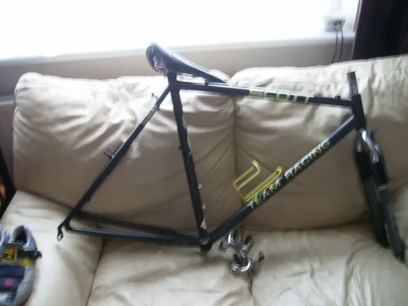

they are normal forks , not carbon bu they are totally seized .
frame is in tange prestige . identical to a P series from ritchey .
shame there is a ding underneath the bottle cage and it is a bit too big for me , it is a 19 .

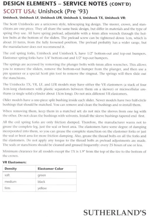

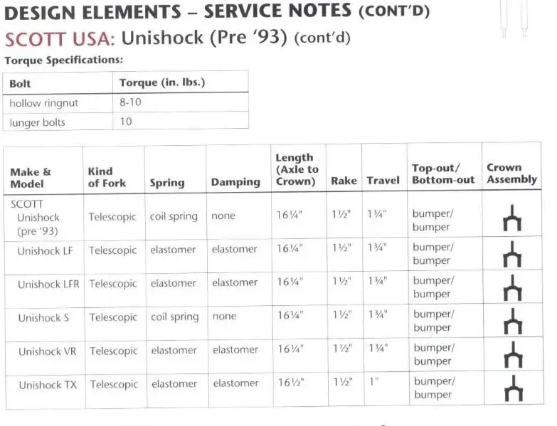

holly thread bump, but anyone any more info on these :-)
Let's build some info on them.
There is nothing in the Archive on them. No service docs and I don't think I collected anything over the years.
No reason.. well I may have some LFRs hopefully turning up at some point.
Sutherlands 6th
