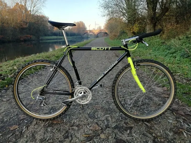

The grip on my AT2 was completely gone. I bought some (cheapish) extra large foam grips so it's a one piece bar grip again.
Alternative for soaking and soaping is hairspray (to slide them over the bare metal).
Only pic I have here. Will take one from the grip if interested.
Funnily enough, it's the same bike as my one with the aforementioned grips. Only mine has Pace RC35s on

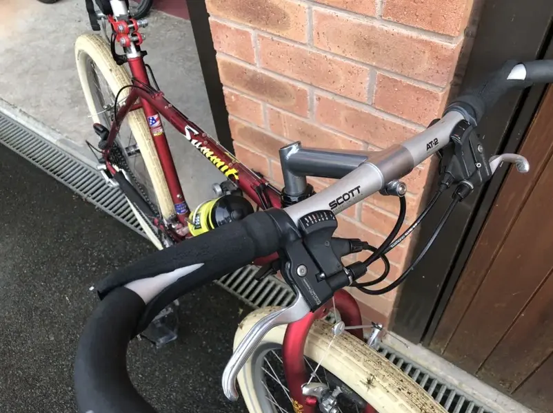

What I have done to my Scott Boulder '94 AT2 before to put a drop bar was a double layer of Fizik 2mm black bar tape, not very cheap option but i found it even better than the foam grips. Must have photos somewhere.
Excellent thanks for the suggestions.. I have some bar cork tape already so will give that a bash, bar end grips are mint still. Only paid £50 for the bike but want it to be presentable!!
For Scott AT bars, you can just wrap cork tape around the entire bar, because you will want to grab it in all different areas. It works quite well.
