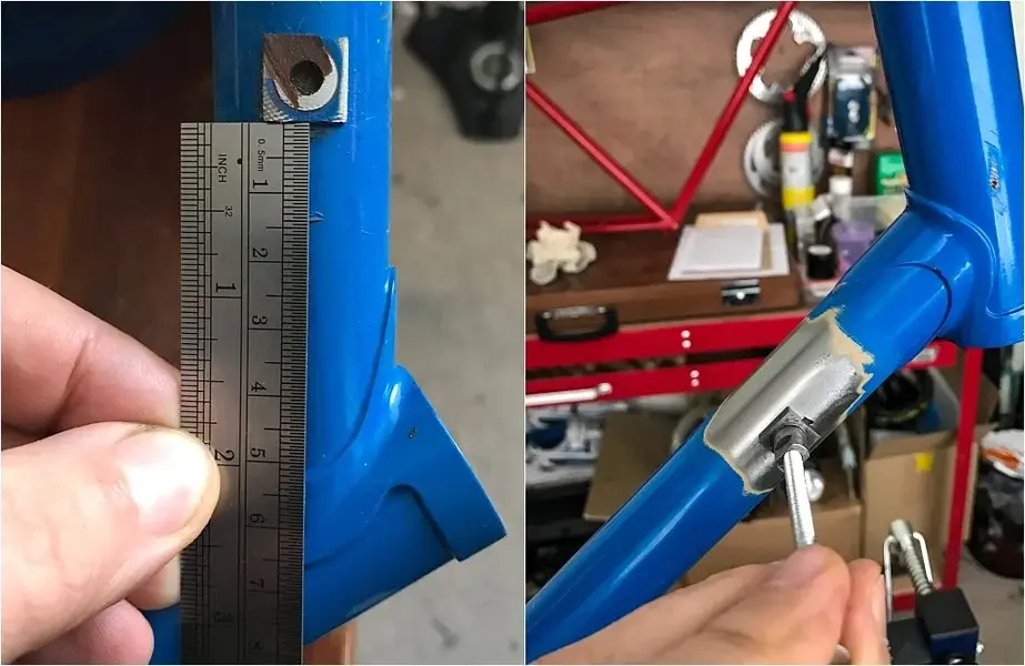

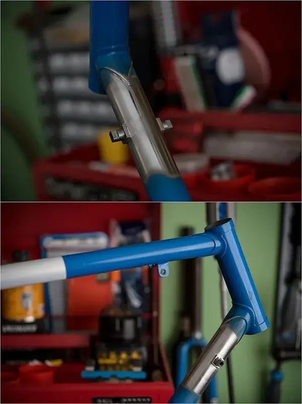

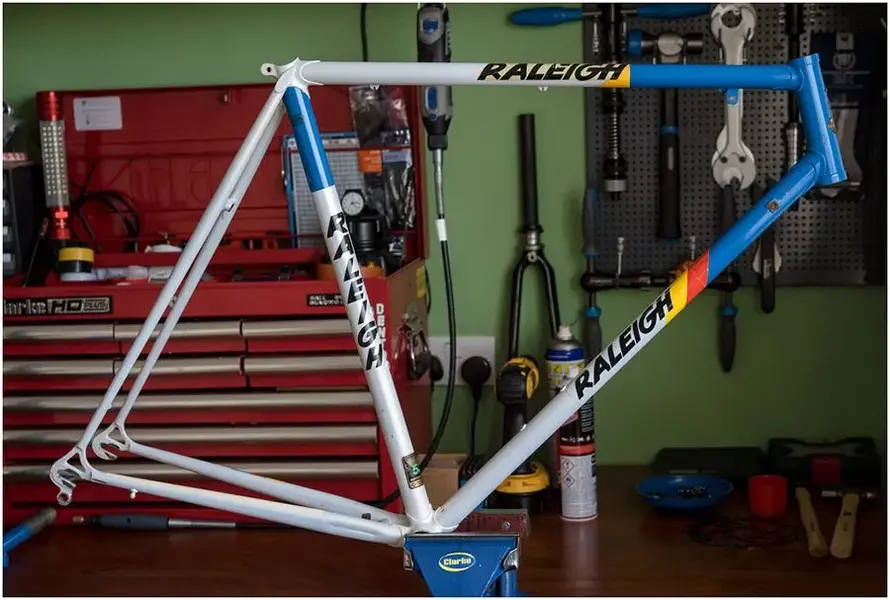

I've had this frame for about 18 months now but don't know if I've ever shown it here. I bought it knowing that it had some damage, the gear lever bosses had been hacked off... and at some point, someone had done a bad job of fitting transfers. However, there is always hope with steel!
As it is a Services des Courses model, it is Cinelli throughout... lugs, BB and CC fork crown.
So taking advantage of the Easter weekend break and using the skills gained from the awesome Dave Yates frame building classes, I decided to tackle replacing the lever bosses.
The seller actually included a new set of lever bosses with the frame...
  • 1 SBDU Ilkeston Panasonic Raleigh Services des Courses Reynolds 531 1984 SB6560.webp
  • 3 SB6560 1984 531c Services des Courses Panasonic Raleigh Frame Damaged Gear Lever Boss - Copy.webp

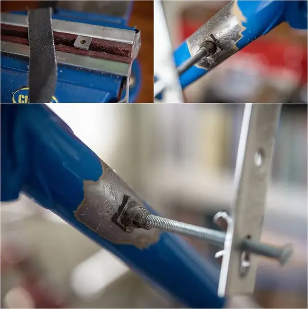

  • 4 SB6560 1984 531c Services des Courses Panasonic Raleigh Frame Removing Gear Lever Boss.webp

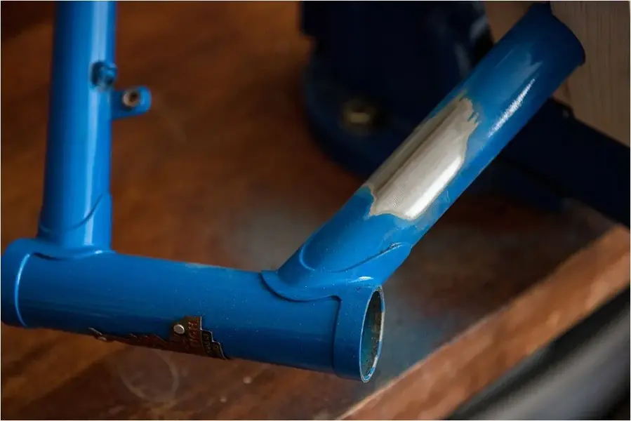

  • 5 SB6560 1984 531c Services des Courses Panasonic Raleigh Frame Gear Lever Boss Removed.webp
  • 6 SB6560 1984 531c Services des Courses Panasonic Raleigh Frame Ready for New Bosses.webp
  • 7 SB6560 1984 531c Services des Courses Panasonic Raleigh Frame New Gear Lever Bosses.webp

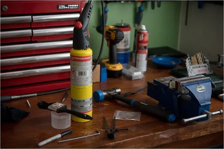

and today I managed to fit them...
A few inches of paint and new transfers and it will be ready :-)

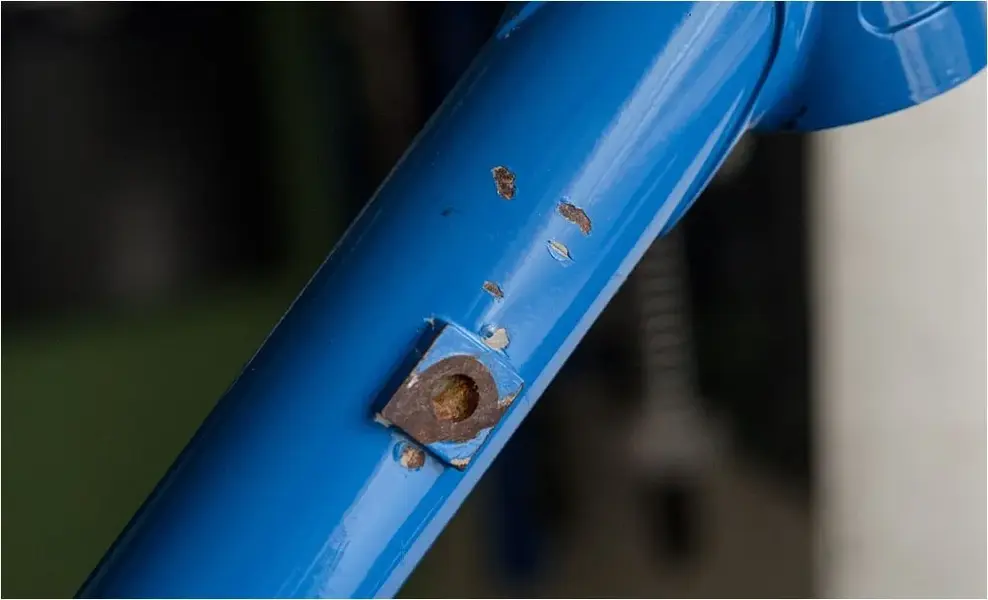

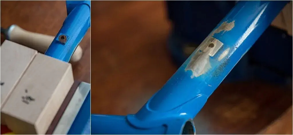

  • 8 SB6560 1984 531c Services des Courses Panasonic Raleigh Frame Locating Gear Lever Boss.webp
  • 9 SB6560 1984 531c Services des Courses Panasonic Raleigh Frame Cleaning Up.webp

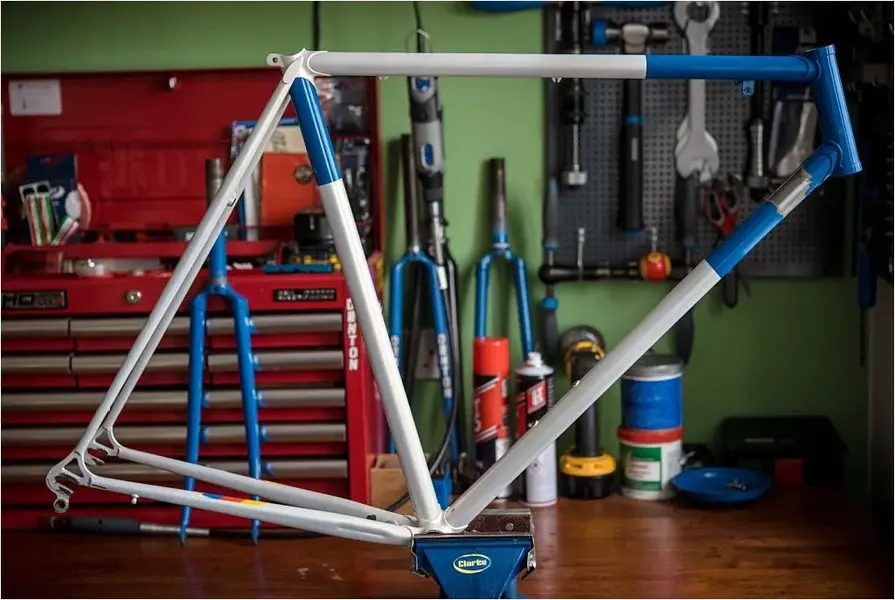

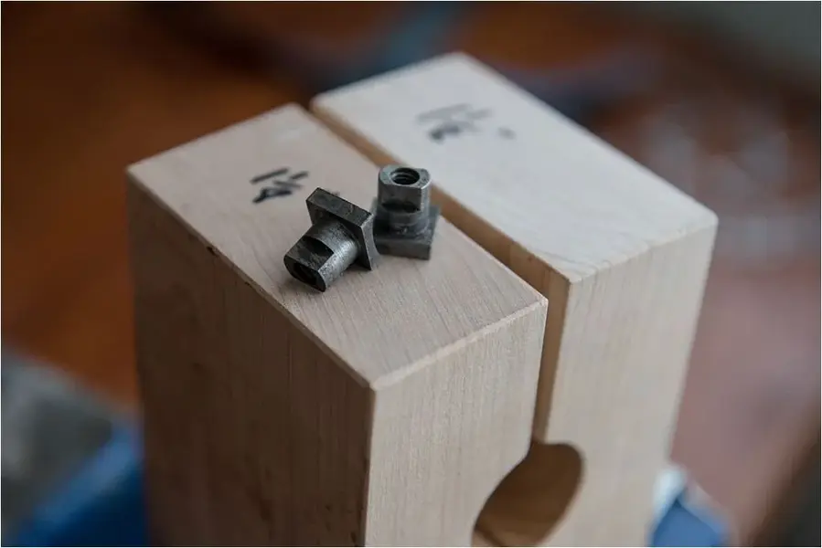

stevevw":3kluqcmt said:
Where did you get the tube blocks from? I could do with a set.
Great job by the way.
Thank you. These blocks are made of Maple by a guy in the US. I saw them on the Facebook page called "Frame Building Tools and Supplies" - there are lots of aluminium blocks available to do the same but I like these wooden blocks, I can imagine them lasting a good few years! He supplies a full set for Imperial size tubes and stays plus a couple of over size options - there are 6 pairs of blocks in the set.
Rod_Saetan":a2mqkzkl said:
Great job, and it looks like a wonderful home workshop set up you have too.
Thanks, I have an understanding wife who donated a spare bedroom, so the workshop comes with adjacent toilet facilities, utilities including power and heat plus free wifi :-)
originalshinkicker":5wmogfk5 said:
I hope it has tea & coffee making facility also :D
