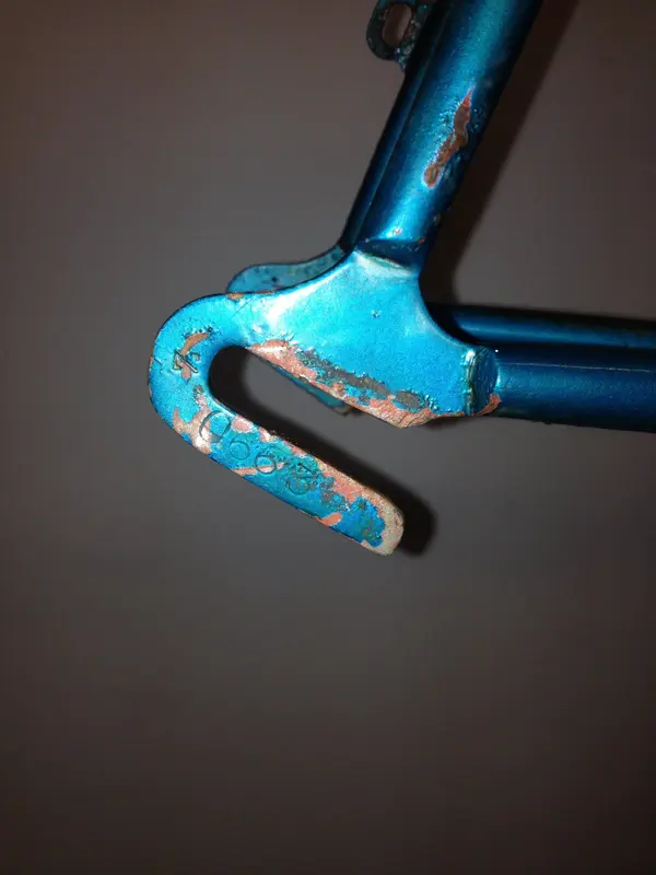

Manage to find five minutes to have a further look at this today and I found the number 0663 stamped onto the drive side dropout. Does this help at all?
the mystery thickens...
The Geometry is consistent with the 38/39 frame, but the head lugs are consistent with the slightly earlier Saxons.
26" wheels are more likely to be pre war...
The frame number is NOT consistent with the 38/39 Saxons, nor is it consistent with Claud Butler numbering (admittedly on different geometry twin tube frames)
The transfers are of post war vintage which is not necessarily totally definitive. (eg I had a pre war Saxon that had been resprayed in the 50s with these transfers.)
Save for the headset which is consistent with pre-war frames, the componentry is more aligned with post war than pre war (but components may have been changed).
So, in conclusion, I think you have got an extremely rare machine, probably produced in the period after it is thought Saxon had ceased trading, from tubes/lug sets which survived the bombing... which Is pretty much what I think Retro Guru Terry was concluding back in November.
I would not respray whatever you do, you would drastically reduce the value of this frame.
