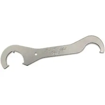

What tool did you use for the bottom bracket? Same as a "normal" square taper one? Need to know for when I attack the sahara, or is it one like this?
I have to confess, I took it my newly aquired friendly old bike shop where they have all the tools! They struggled a bit but added some heat and got there in the end without damaging paintwork!

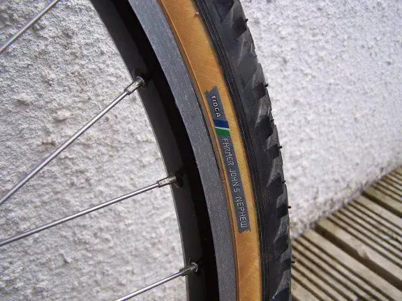

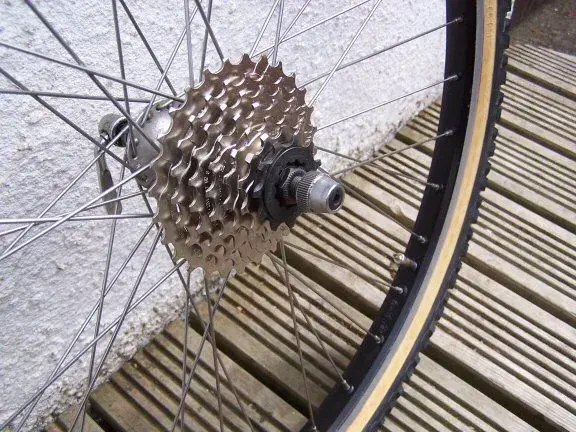

Wasnt going to use the original wheels but I have!!
They have come up a treat with a bit of T-cut. The rear is now 7 speed and quick release, plus all new bearings front and rear.

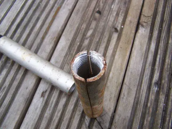

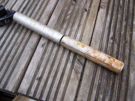

Got the old seat post out (the man in the shed did) he tapped it and screwed a big bolt into and then pulled it out eventually. It was already split down the length, strange that it got pushed all the way in, I would have thought that once it was split it would have come out ok.
Oh well its out now, my OCD is happy!!

That is looking really nice, great idea on the seatpost as well, that has come out a beauty. I would have been paranoid too knowing it was there and would have got it out somehow.
Wow :shock: the bike is starting to look really good, I reckon at this pace you will have it ready for the Bristol ride next month :wink: I could be persueded to bring a bring a Saracen....... :lol:
Im liking your style with the seized post 8)
