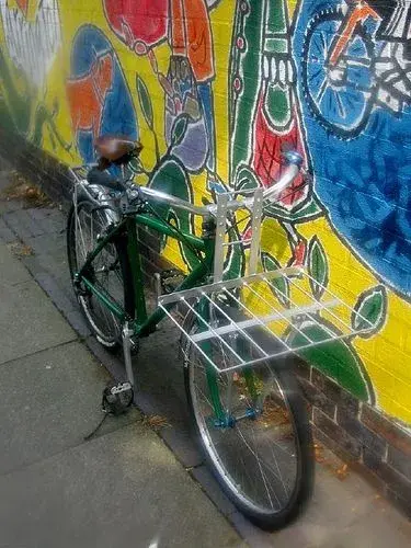

Here it is in it's previous shopper incarnation! Exactly why it's got that dodgy soft-focus thing going on, i'm not too sure.
