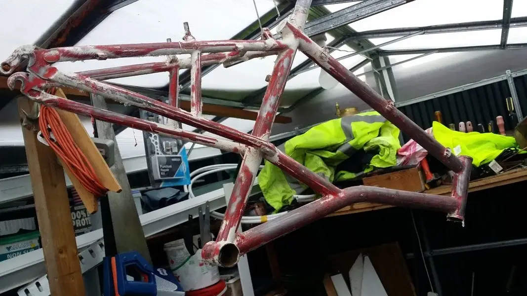

Hello i have now stripped the frame using Peelaway 1 alot of scubbing and scraping te water blasting i need infomation now on the best way to spray it and seal it
I can highly recommend Peelaway 1 as it works great this is the finished frame awaiting painting.
I'd highly recommend finding a powdercoater to powder coat it. It originally had a polyester powder coat, which is pretty much the same as what most industrial powdercoaters still use. Durable and good looking.
DIY rattle can jobs end up being time consuming, the paint finish can be less than perfect and the paint can also be a bit fragile.
The other thing is that while you think you are saving money, the cost of rattle cans soon adds up.
If however you have a compressor and spray gun, then surface prep and high quality paint can yield good results.
But as before, powdercoating would be my choice.
