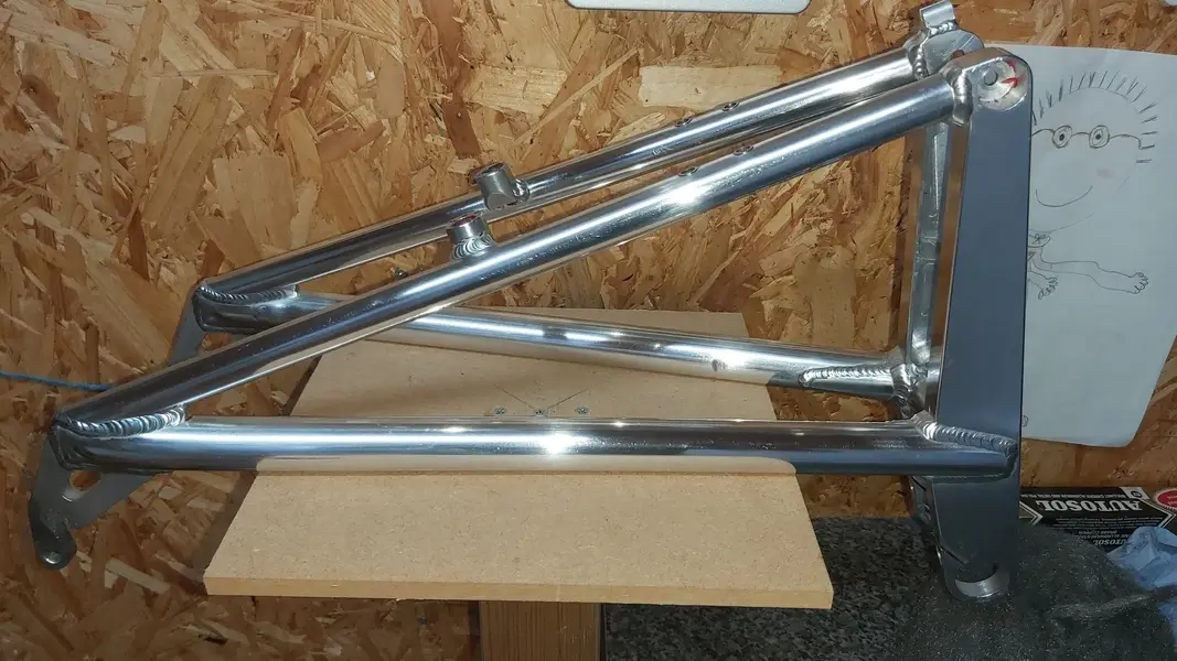

hi there, ive just picked up one of these exact frames today, and was wondering if you had any info on shock mounting hardwear? its the original fox vanilla. also, whats the best way to strip the paint off and then polish it up? do you know the bearing size at all? cheers for any info. also would you know where i could get a full set of decals made up?
The shock mounting hardware you can get from for example offsetbushings.com based on the measurements from the shock and frame. For stripping I've personally used nitromors or similar and then wetsanded it slowly to finer grades. You could also have it mediablasted, but as it is an aluminium frame, you'd have to take it to someone having e.g. sodablasting possibility. So no sandblasting for it. For mine I used Enduro Bearings 1614 2RS which you can find in some bigger online bike shops. And the decals were custom drawn to me by Filip at Stickers Studio in Poland, they have at least facebook and instagram accounts, so contact them!
cheers man, I've stripped it with nitromors, and given it a go over with fine wire wool and wd40 so far. front has gone away for bottle mount replacement, then it'll have a weld redun on the shock mount. 20210818_124426.webp
