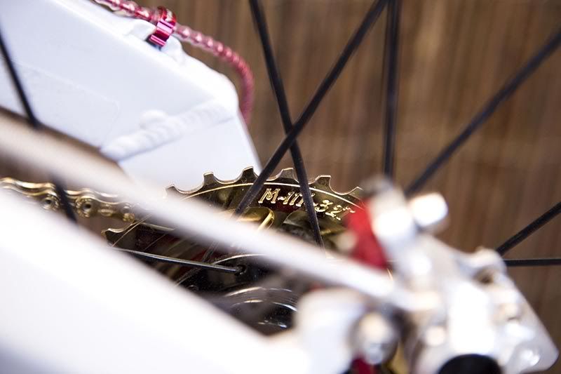

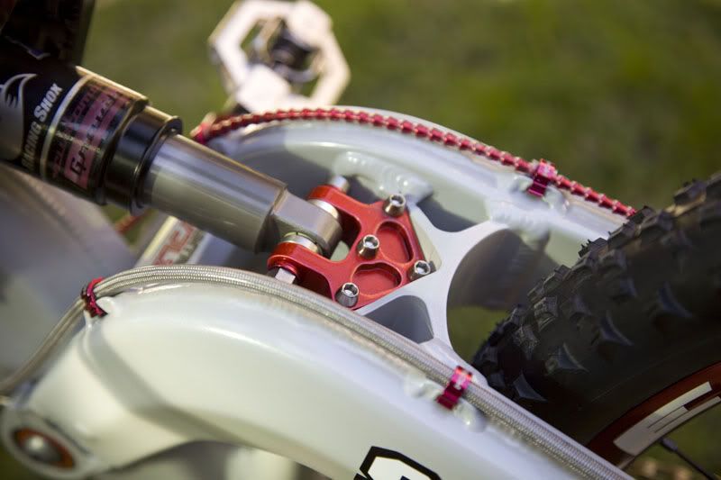

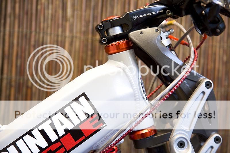

The San Andreas is now finished and I'm extremely happy with this build as it has exceeded my expectations in all areas.
The handling is awesome and I was shocked when I weighed it as I didn't think I could get it so low.
All the original black fittings have been stripped and re-powdercoated in a candy red to match the other red highlights.
Thanks also to John @ Gripsport for an absolutely fantastic powder coating job on the frame. Anyway I don't think
I'll change anything on this one. The specs and pics you will find listed below...
Frame, Forks & Shock
Frame: Mountain Cycle San Andreas
Fork: Hurrycat Vorace XC comp Carbon

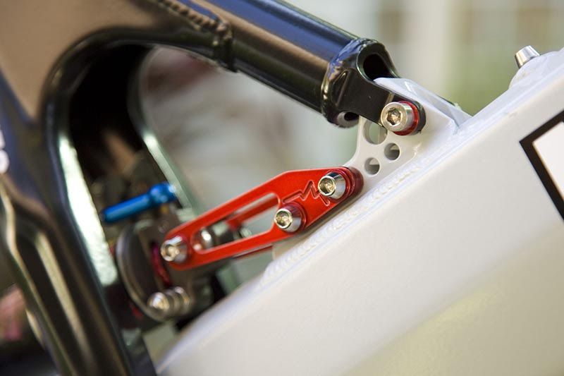

Front Shock - German:A V-Comp 150mm 169g
Rear shock - Fox Float RL

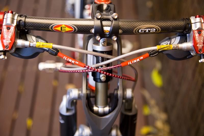

Controls
Handlebars – Easton CT2 Carbon
Stem - Hurrycat (Integrated)
Headset - NC-17 Imperator Pro
Grips - Answer Fall Line DH
Saddle - Koobi PRS Alpha
Seatpost - Thomson Elite
Clamp - KCNC MTB QR

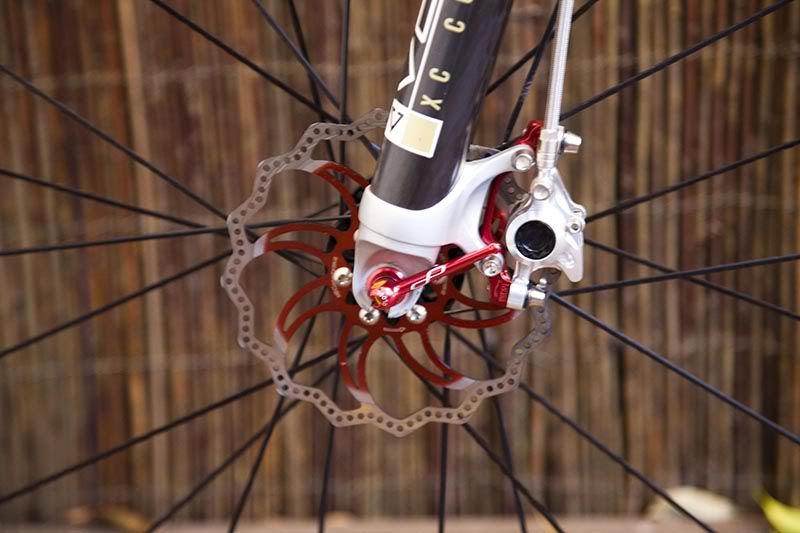

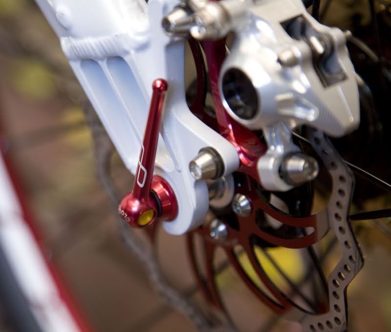

Brakeset
Brakes F/R - Hope Tech X2 with Goodridge braided Hose & fittings
Adapters F/R - North Shore Billet 160mm IS
Rotors F/R - Alligator Starlite 160mm
Silencer - SwissStop brake pad silencer (This stuff is freekin awesome!!)

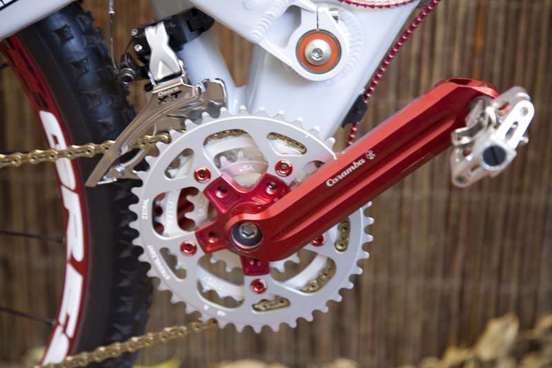

Drivetrain
Bottom Bracket - CrankCase Sealed 117.5mm
Cranks - Caramba Double Barrel
Chainrings - Stronglight Zicral
Chain - Rotor SL901 Titanium
Pedals - Crank Brothers Candy 2
Front derailleur - Shimano XT
Rear derailleur - Sram x5
Rear shifter - Sram x7
Front shifter - Sram x7
Cassette - Recon One-Piece Alloy 9sp 11-32 138g
Shift Cable - Alligator iLink 4mm
Wheels
Front rim - Progress XCD-1 (Niobium) AM/XC
Rear rim - Progress XCD-1 (Niobium) AM/XC
Front hub - Turbine CNC 24h
Rear hub - Turbine CNC 24h
Spokes - CN Blade Aero 3mm
Skewers - SpeedPark Titanium MTB
Weight pair:* 1575g including Skewers
Tyres/Tubes
Tyres - Schwalbe Rocket Ron Performance 26x2.10
Tubes - Maxxis FlyWeight presta 26x2.10
Extras
All bolts where possible - Probolt Titanium

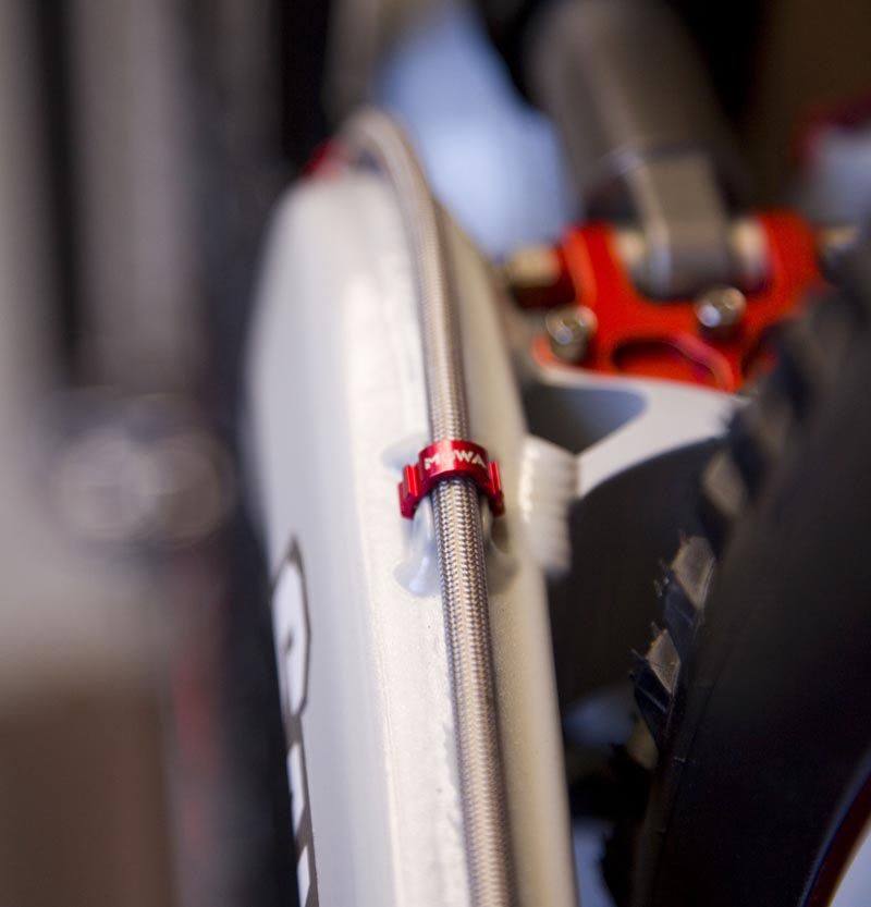

Cable mounts - Triple (Ragley), Single (Mowa)
Cylinder Lids - Hope Tech red
Bar Ends - Zeta
Total weight - 11.8 kg
