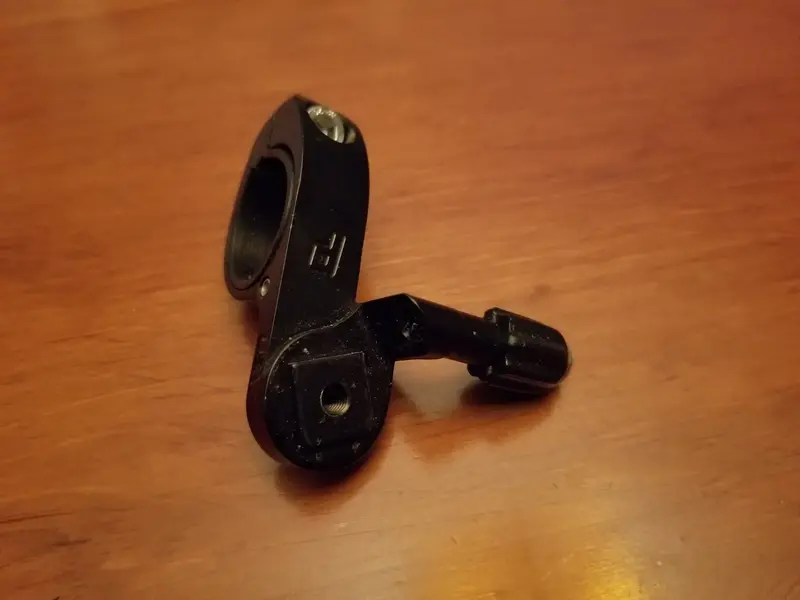

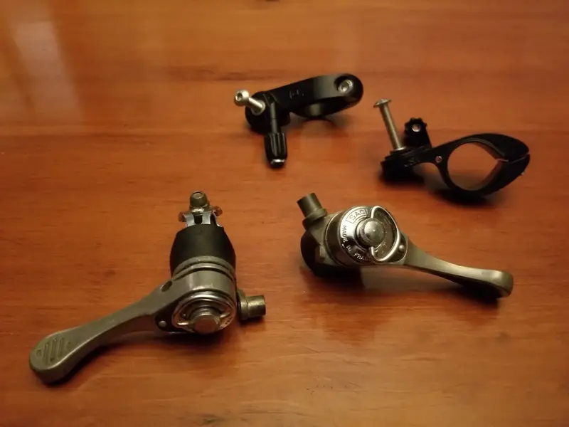

After switching many stems, bars, and bikes one of the crummy steel band clamps snapped. I bought the Paul thumbies a few years ago and now is the time to bring them together. They will need a spacer with a square recess to fit the square boss on the clamps. There will be fettling but I have a vision.

Do the mounts dissaemble any further?
I recently paired some Huret downtube shifters with Pauls mounts, but that was probably simpler:
https://www.retrobike.co.uk/threads/aende.263438/post-3171839
The post/boss is flanged/rivetted? inside the black base so I have to dremel that away to pull the bases apart. Did one and it came out easily. Thanks for the link, it's inspiring to see that someone has done this already and it works.
For this job I need a couple custom spacers and luckily have a mate with a machine shop. I dropped off this Post-it note drawing for him today.

I occasionally keep my eye out for more of them on ebay, and bought a single right-hand shifter a few months ago as a spare, or for a future 1 x drivetrain set-up.
If its of any use to you, the current (and expensive) Dia-Compe ENE down tube shifters share the same 'clicky' ratcheting as those Huret levers. Suntour do similar too.
That may give you better mounting options

Those are nice, thanks. I have a pair of the ones they make for Rivendell. These ones I'm trying to save for nostalgic reasons.
