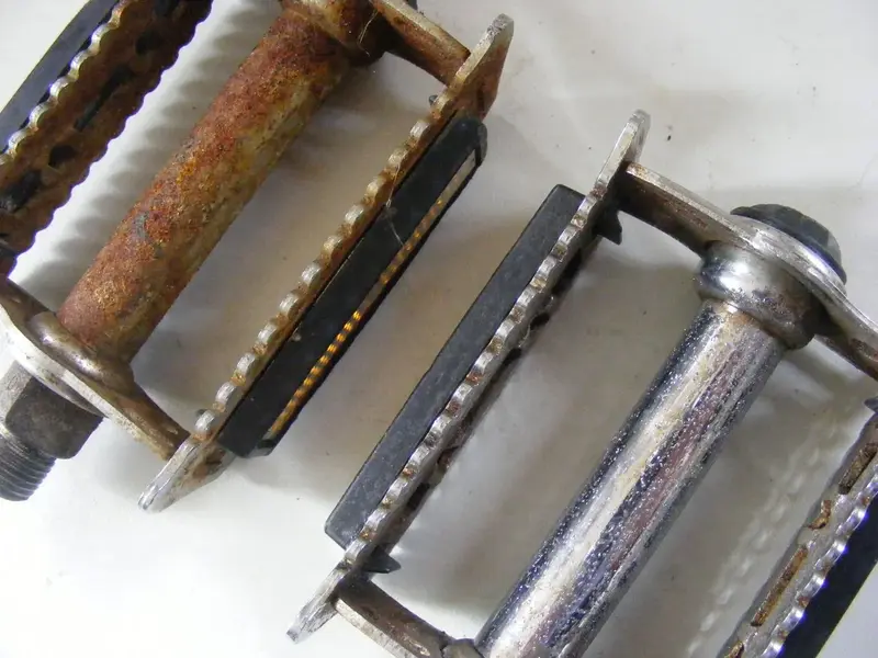

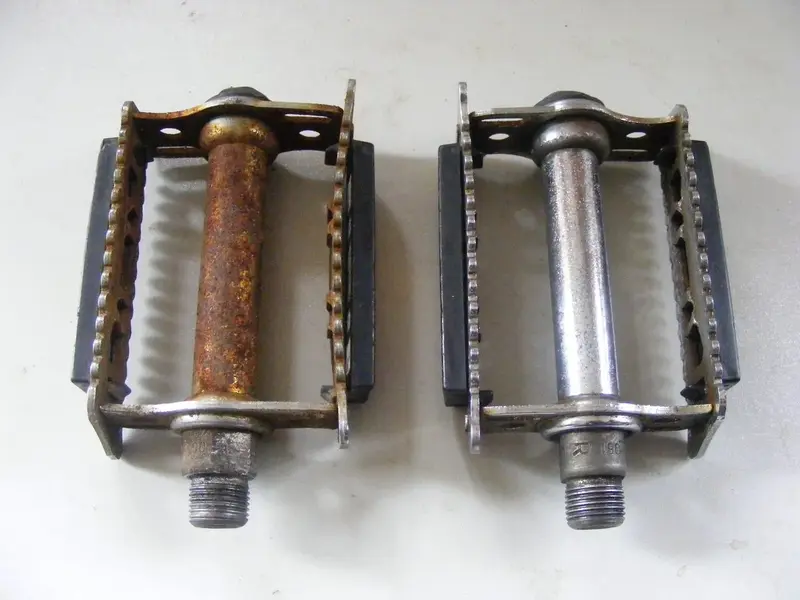

don't laugh, cooking foil and vinegar... try it on something bad first! I'll post some pics of before and after old chrome rims...
Going to try aluminium foil and acid on my Falcon chrome forks...not been touched in over 30 years.
The aluminium is more reactive than iron and should displace it from the rust giving rise to metallic iron and aluminium oxide. Well that's the theory as I read it :)
Shaun
before and after
OK, pair of severely kak pedals, i used just silver paper and malt vinegar, then washed off with soapy water and dried...then a lights wipe with 3 in 1;
by no means perfect but a restoration is a sum of the parts; you either work with what you have and accept the limitations or buy new stuff... :)
