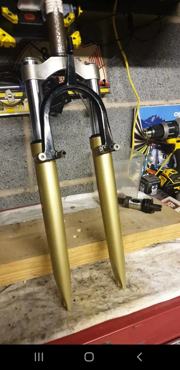

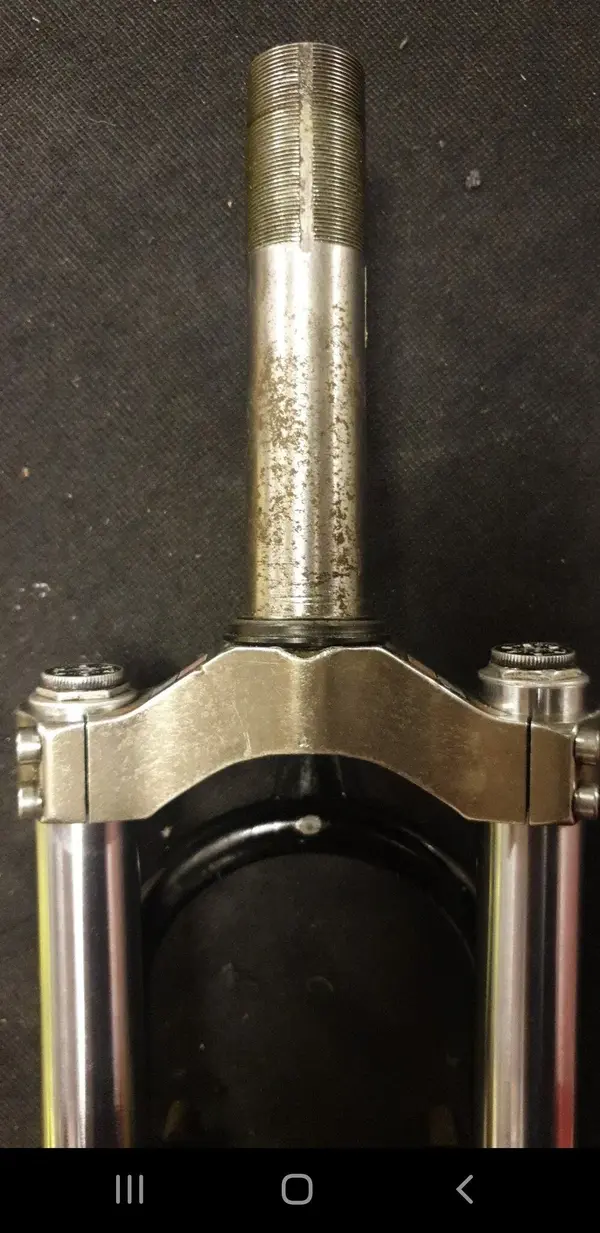

Hi , I've a set of Mag 20s that are testing me. One leg won't return back to full length, I've removed the clip and I'm unable to to get the leg split even with 100psi in .
I had a set like that, both legs, I think leaving it for 5years and some stuff sorted it.
I know I looked at DIY pullers.
Maybe alter the oil inside a bit, can't remember.
Maybe I hammered the lower off, or pulled apart somehow.
MAG20 should be easier for brute force as they don't have the negative spring
Could try lifting the seal edges and getting lube in the, could get some heat around the seals etc.
