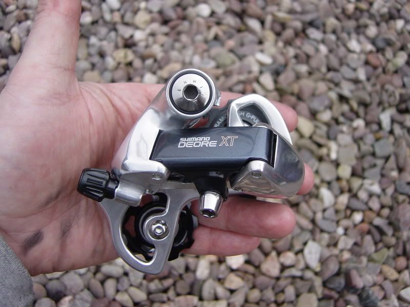

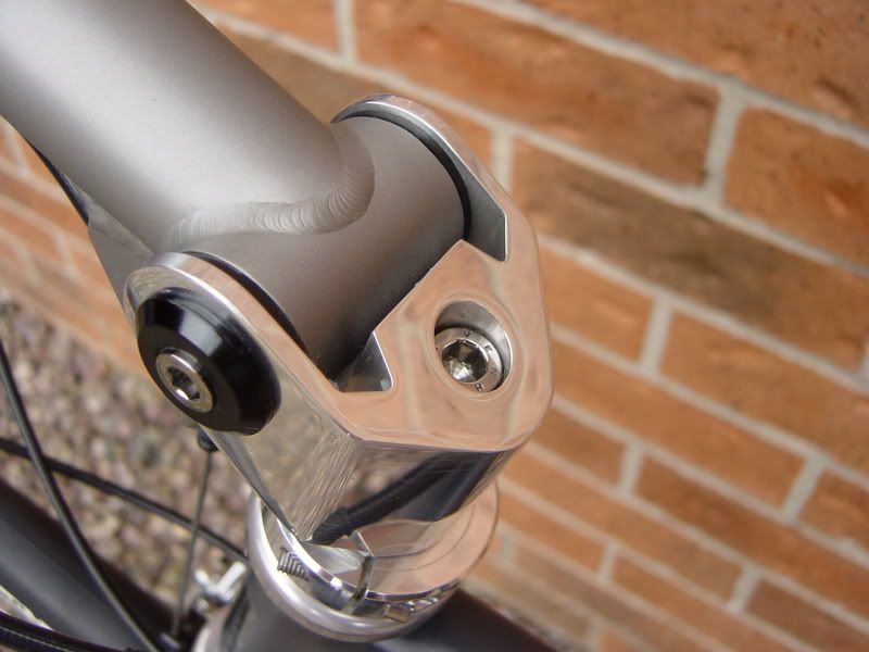

I have polished Ti and stainless in the same way and it is nigh on impossible to distinguish with the naked eye, never mind trying to capture it on film - I think the angle and what is seen in the reflection can skew a photo easily. Stainless, chrome & Ti :
Polished Ti :
Polished Ti, ally and stainless - the Ti in this one looks more 'silver' than the ally. (Should have wiped the grease marks of first sorry :oops: :lol:) :
Chris's polished Ti is the same to :
WD :D
