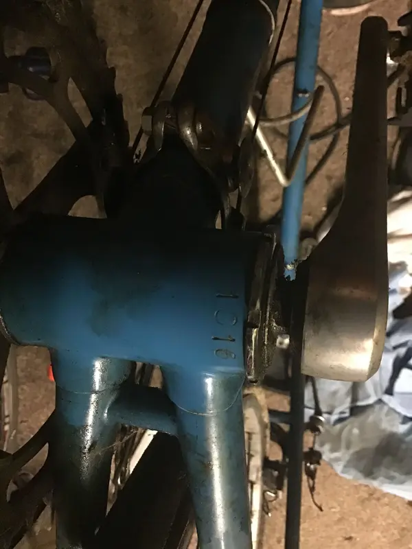

Is there a frame number under the bottom bracket?

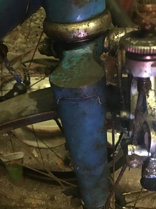

That does look totally original. Could easily be a '73/4 shop Holdsworth that's been back to the shop for a respray. A Strada like you say, except that it maybe started out as a Holdsworth Strada. Those ain't Precisa forks. You need to strip all the components off the frame, hopefully nothing is stuck- then you can make sure that what you've got framewise is structurally sound.
Oops, as torquless says the forks are not straight, any pics of the top of the forks from the side?
Forks frame no.

Is that the whole number? Four digits?
