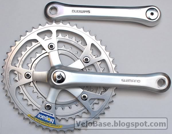

IMHO Biopace was a rubbish idea that tarnished elliptical rings, even now 25 years later...the alignment of the rings was totally wrong. Look where the high spots are:
The idea was that the drop in gear as the pedal moved past TDC accelerated the leg and thus gave a little more kinetic energy to get past the dead spot at the bottom. It didn't work for me, on or off road, and smooth pedalling was almost impossible. I rotated my rings 1 hole clockwise. This improved things a lot.

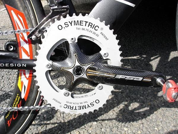

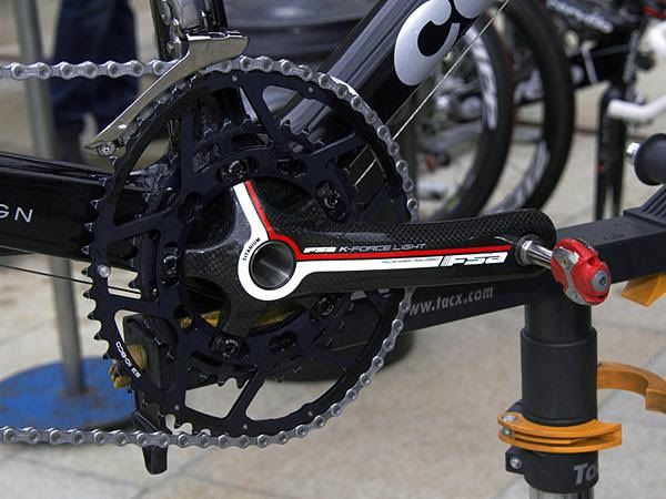

Wiggins uses the slightly different Osymetricrings. These are fixed position, quasi-square rings from France, with a big high/low difference. They claim a 10% wattage gain, so approx 3% speed gain. They look pretty extreme to me...God knows what the front shifting is like...
