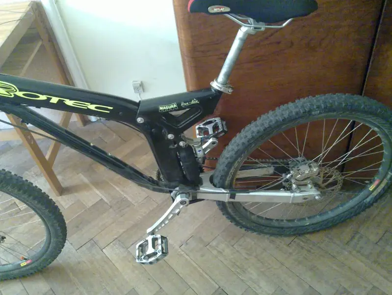

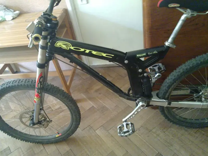

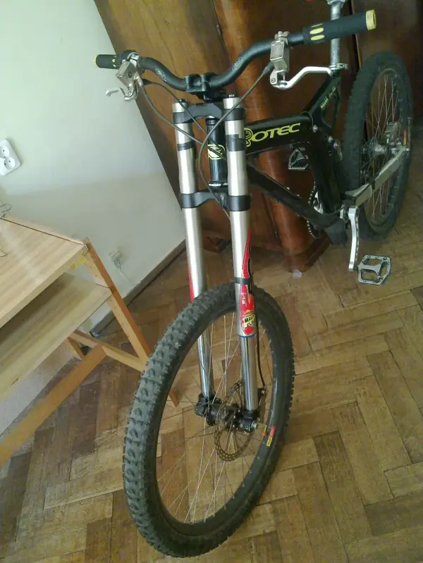

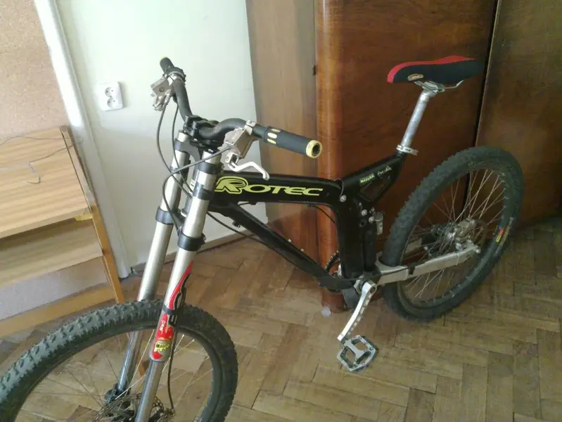

My history:
I was searching some frame with Lawwill system and nice condition, good looking. But suddenly I find Rotec in good condition, no scratches and nice price. After few mails with trader I bought it. When I buoght Rotec 5 or 4 years ago I can't find any information about frame. John Sullivan helps me to determine basic information.
Now this frame and brand is cult, rare (in my country is 1-2 new Rotec's RL9 and mine).
I give some pictures which I take 5 minutes ago and some with Rotec(and me) in action.
