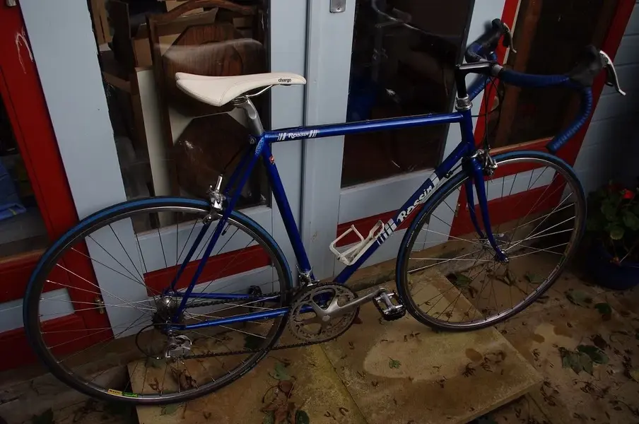

I purchased this bike yesterday, the previous owner having upgraded to titanium. I was on the look out for a steel frame road bike and hopefully this will fit the bill :)
The original gearing has been changed to lever operation with Chorus rears and brakes are Shimano RX100's.
Wheels are Mavic MA2's.
Can anyone help me with possible age and model? I think it is a lower spec model as it has Columbus Zeta framing, heavy by Columbus standards but featherweight compared to my MTB and CX bikes!
I'm guessing it is mid/late eighties, the badge on the head post is the 'R' in the pentagon and it has the 'R' cut out underneath. Interestingly the cables go over the bottom bracket rather than underneath.

Very smart :)
If there are 2 small holes in the dropout above and below the rear mech bolt then the dropout is for a Portacatena device. That dates it to late 70's to the early 80's. That explains the over bottom bracket cable runs and the gear cable along the top tube. Would have originally had downtube shifters.
Interesting stem as well:D

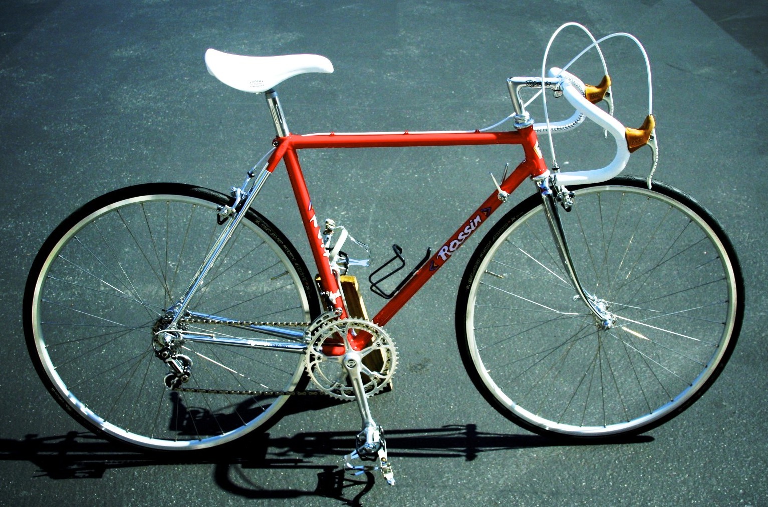

Here you go, early 80's Rossin with cables and likely Portacatena dropouts like yours.........
http://rossinproject.blogspot.co.uk/201 ... -from.html
Shaun
Thanks Shaun, just checked, there are two small holes, above left and bottom right from the rear mech bolt, I suspect that little but the frame is original although the bars are Cinelli Criterium. Lovely original bike in the photo.
I took it out for a quick ride this morning and it feels very solid and together.
I'm new to older cycles, what is interesting about the stem?
Rob
The stem looks like a black Cinelli 1R but with two grooves milled on the sides...........often get anything from SABA to Rossin pantographed on but don't recall seeing a grooved one..........
Shaun
