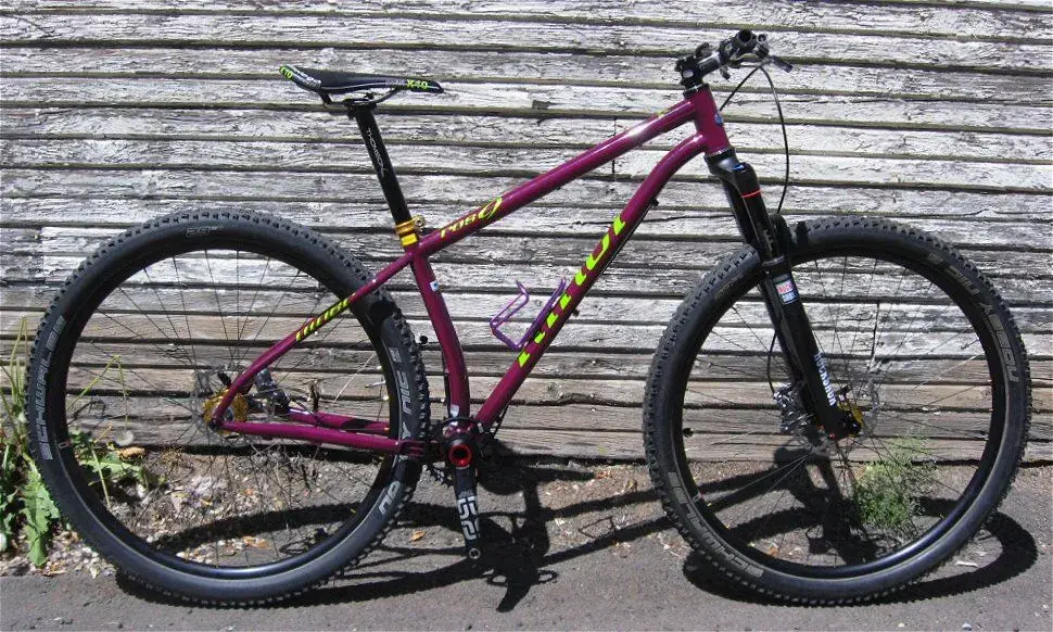

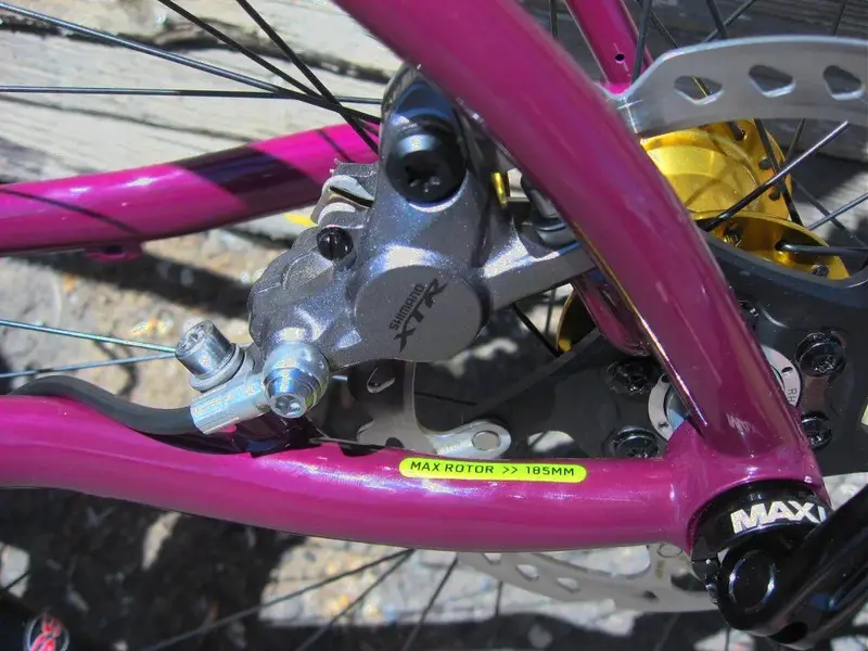

Starting to look like a bike.
Finally managed to get the bike rolling, and boy does it roll. Super smooth ride with excellent trail manners. Love it.

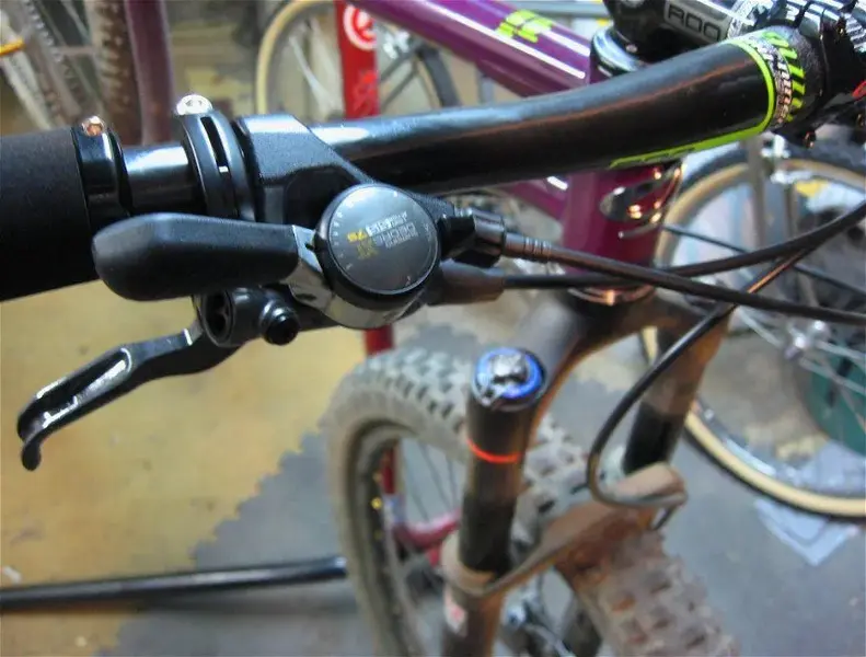

11spd XT cassette isn't available for a few more weeks so i had to go a different route. Drivetrain is currently a strange mix of M9000 11spd RD, 7 speed Hyperglide cassette, and a old XT thumbshifter. It actually worked quite well.

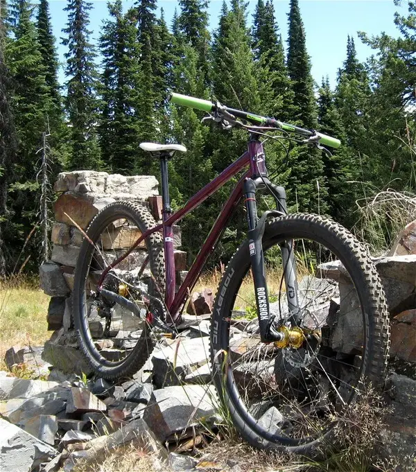

Semi-final build pictures on a Northern Idaho summit.
This ride taught me a valuable lesson, when running a 1x system use either a chain guard or a narrow wide ring. Chain drop was endless on this ride and totally frustrating.
Next order of business was to order a e13 narrow wide ring. 100 miles later and not even one dropped chain!
For those interested, the Ros9 with a 120mm fork rides fantastic. Predicatable on the downs, and climbs great with the steep seat tube angle/short stays.
Overall the bike rides exactly how I hoped. Weight is 26lbs with 2.35 800g Nics. I could save some wheel weight but the extra cush really feels great!
