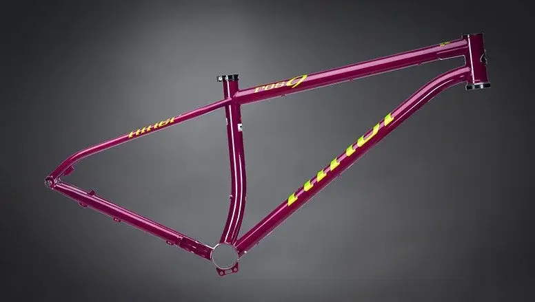

Frame is a medium ROS in purple. 6lbs of oversized 4130. The idea behind the geometry is to have a slack hta, short cs, durable all mountain hardtail. Frame is designed for either a 120mm fork or 140mm, putting the hta at 67 or 68 degrees.
I've always been more cross country minded and value lightweight over downhill prowess, so my build is leaning tword the lighter end of the bicycle spectrum.

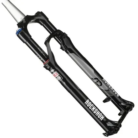

Rock Shox SID RCT3, 120mm travel, 15mm thru, 1588g.

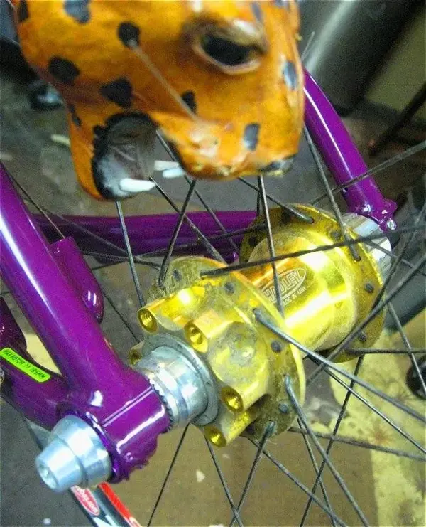

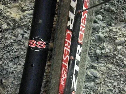

Hadley hubs laced with Revo spokes to Velocity Blunt SS rims. I'm very excited to try these mid-width rims. 1500g.

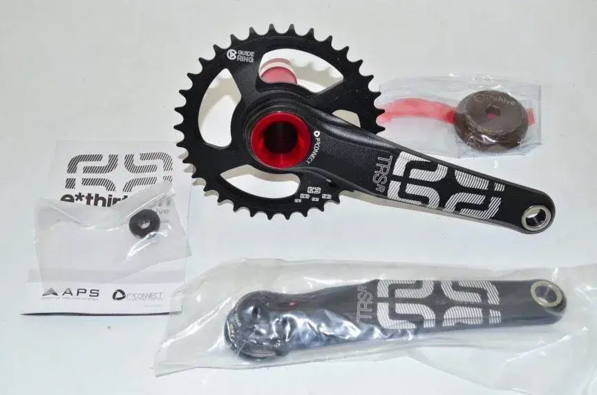

E13 TRSr cranks. 180 length. I like to run 180's on my singlespeed and these popped up for a good price so I took a chance. They look really nice. 600g.

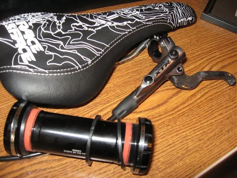

Thompson Seatpost, Race Face Atlas (ti railed) saddle.
Niner RDO 80mm stem, RDO bar. Both black with green accents.
Shimano M9000 brakes. These killed my budget but they look so cool and should perform great.

Currently trying to locate an afforable (to me) bb30 bottom bracket to be able to proceed with the build. There are not as many options as one would think.
Aside from the brakes and fork this build is on a serious budget. The Wife just doesn't understand and i've given up trying to explain...
I'm fairly sure the ROS9+ is the only frame from Niner that can run the 29+, 3" tires. The ROS9 has a new cast chainstay yoke allowing 2.35"s to fit with a little room to spare.
Friday was a big parts day. Picked up my brakes, saddle, and bb30 bottom, bracket.
