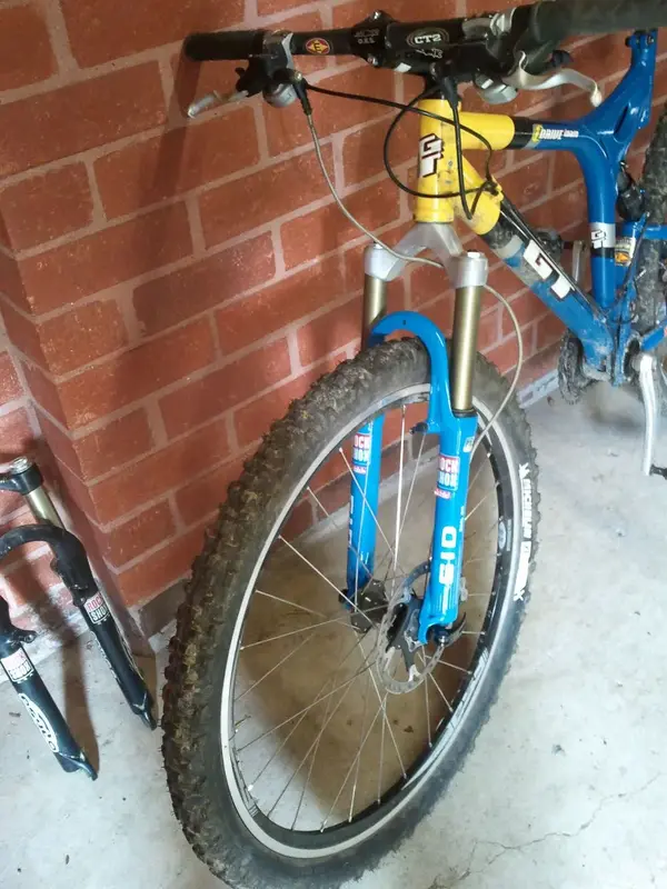

Can anyone help me with how to setup some SIDs? I've never had any of these and am a bit puzzled by the number of air valves... There seems to be one on the top of the drive side fork leg and two on the non-drive side, one at either end.
Can anyone tell me what each of these do? I presume the one at the bottom of the non-drive side is for the negative air spring... are the other two both the positive air spring? Should they all be at the same pressure?
The forks are the ones shown on the bike below. Any help with the setup would be great! I don't really want to just dive in and ruin anything.
