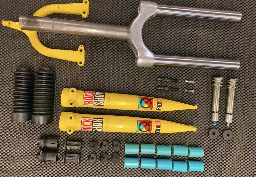

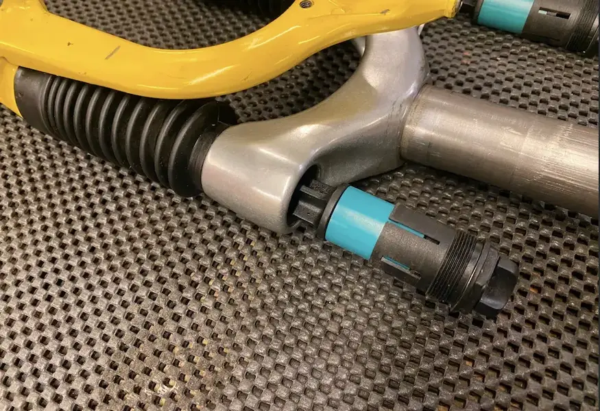

Well ...its plastic in metal. It cant even really be glued together. Please heat it a little and unscrew them counter clockwise. Maybe you turned in the wrong direction :-)
Unfortunately it's a fine thread in plastic and sometimes changes in the materials/overtightness can cause enough fiction to overcome the hex head, even with a well- fitting socket.
On the positive side because its only plastic you can cut out the damaged part, and then hunt down replacements 👍
