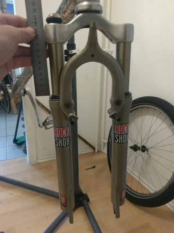

A full fork picture would help.
Anyway got Type2.

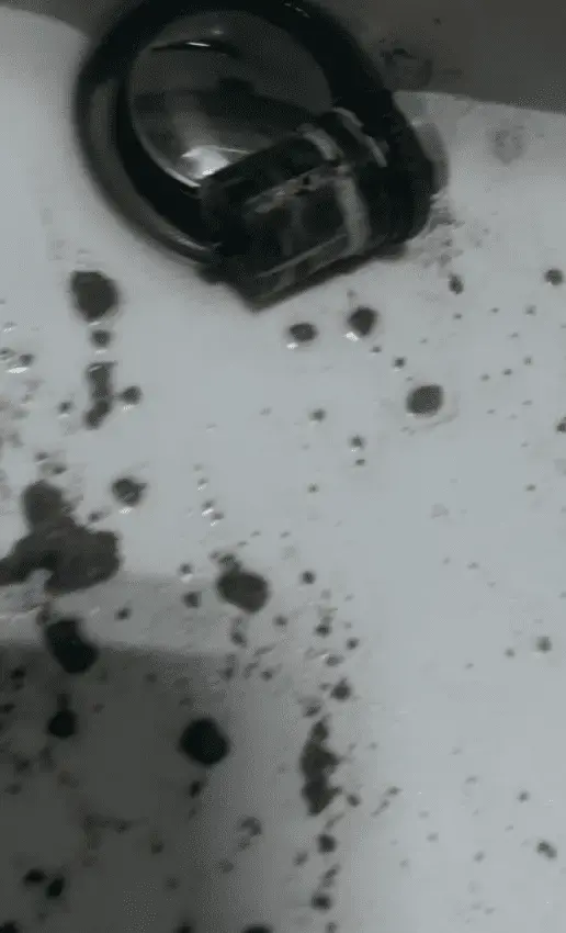

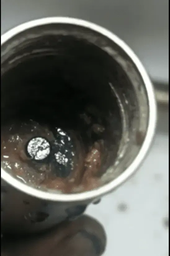

Measuring with the calipers gave me around ≈25mm.

They're 1995/1996 Judy XC, if you have spring in, they've been upgraded.
And your elastomer/mcu may be different as they have to work with the caps there.
In the inside picture I t looked like a Jax Connector.
Any pictures of the innards or what's left.
Once cleaned out, compress the stanchion completely, mark it, the pull it out completely and you can measure the travel. It'll be ~50, 60 or 80 depending on year (damper fitted).
