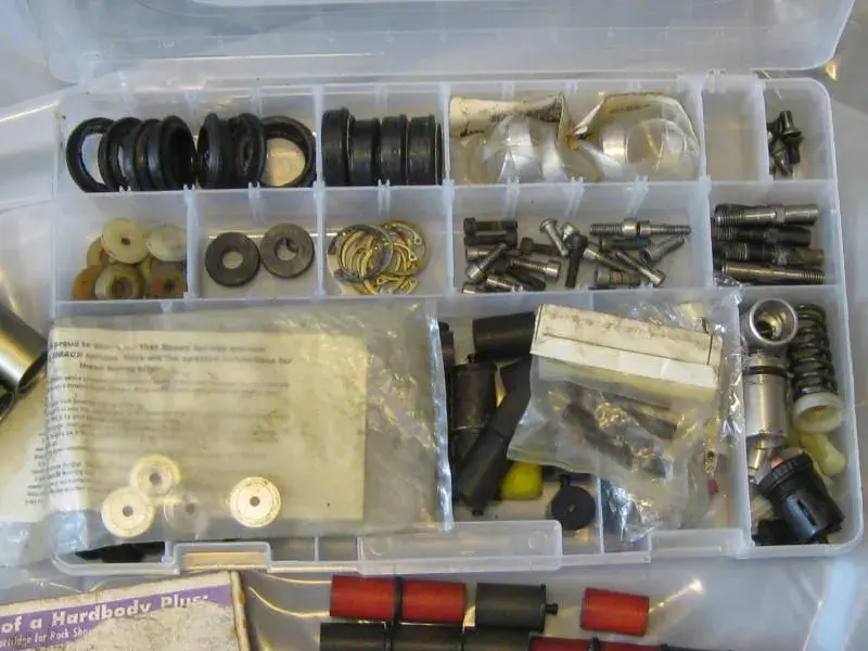

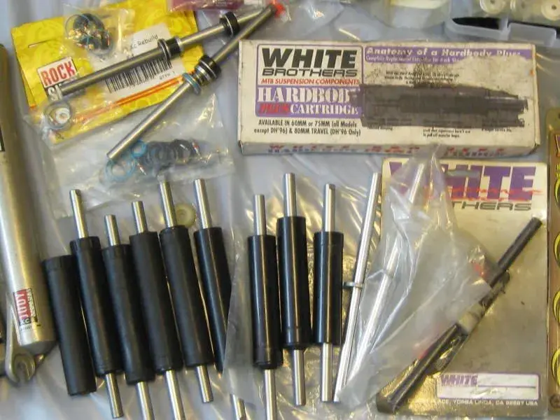

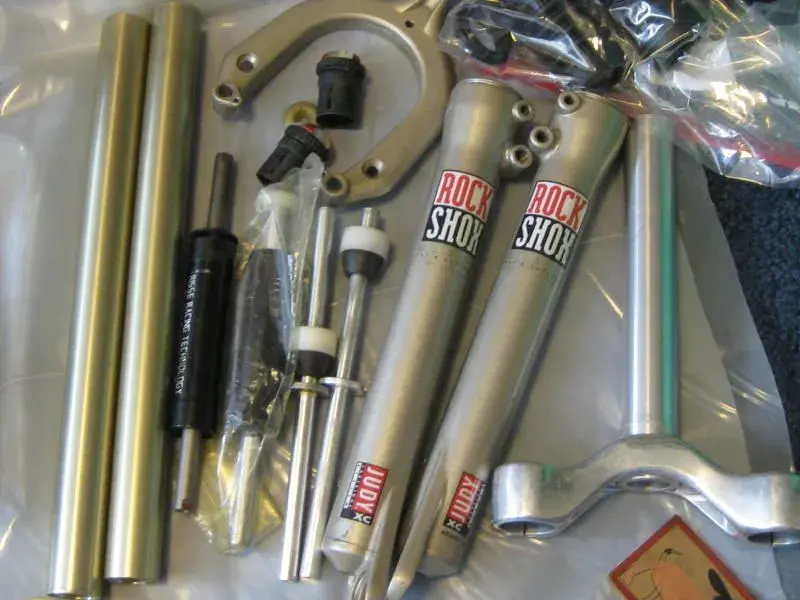

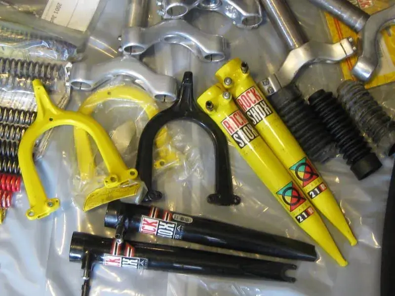

Pictures...
The last pic of the Judy XC parts is the project really, enough good condition and NOS parts to built one really clean fork. Probably try to build one more beater from the parts and get rid of the rest.
