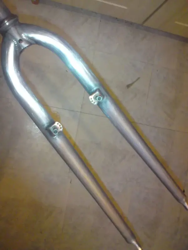

Was gonna flog my rockhopper to raise funds for a Boardman comp but have now decided to strip n clean her and do my first C2C on a retro instead :)
I'm afraid its not gonna be period correct or a BoTM, gotta build on a budget. Cantielvers are soaking in Gunk, forks took off tonight and stripped to the metal. Hopefully pull the crank tomorrow and get cracking on the frame, doing the C2C in april and promised a ride round kielder next sat so gotta get moving.

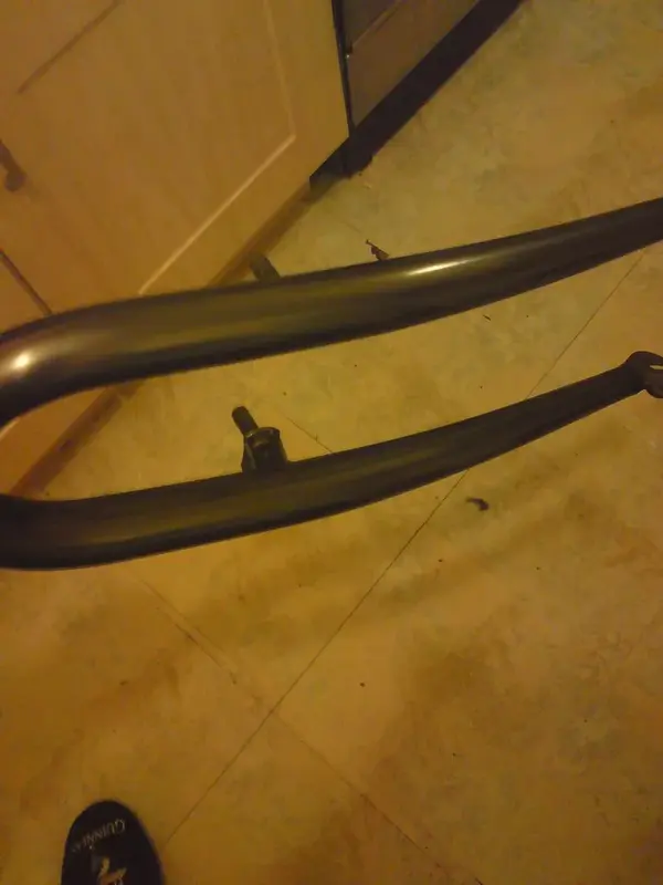

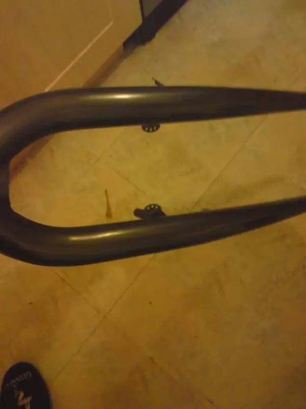

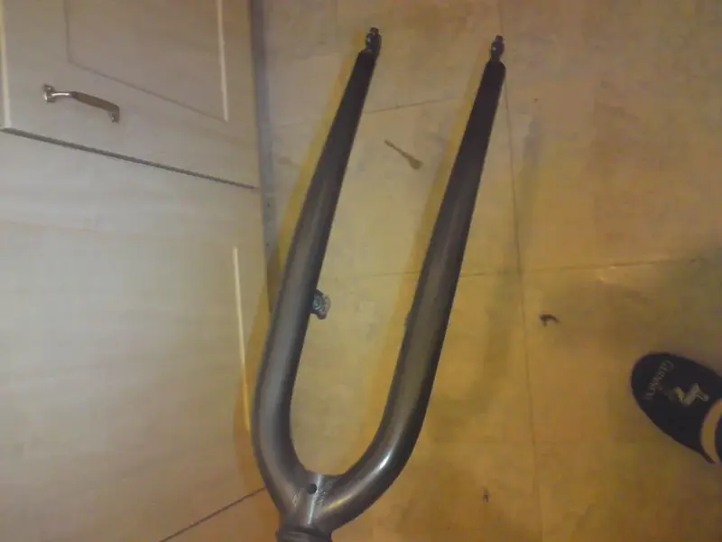

Colour is gonna be a bit different, I'm gonna gun blue the whole frame and forks, done the forks already so pics below. Could do with some advice on a good clear coat for the finish.
Already very pleased with the gun blue, looking forward to getting the frame finished, think the colour would go well with some Ti or carbon parts.

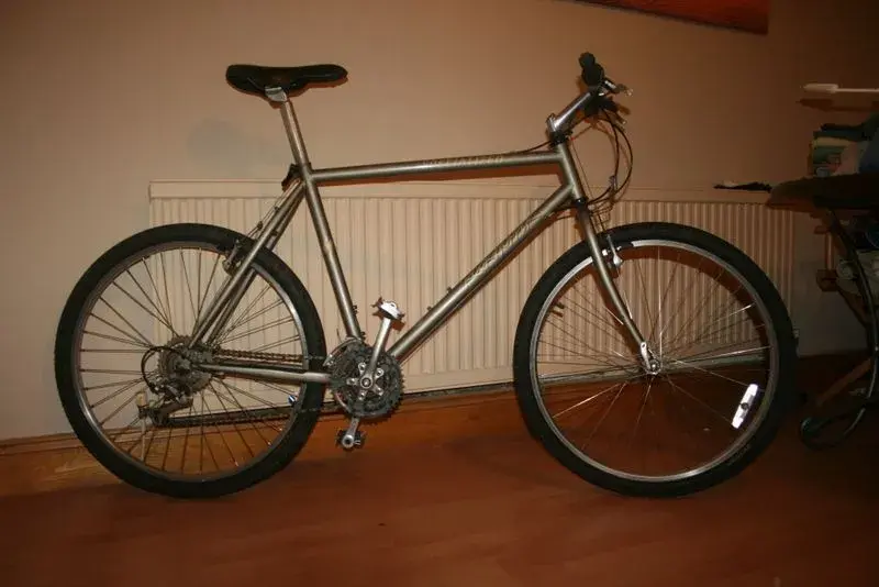

Almost forgot the obligatory 'before' shot
Didn't get a great deal done tonight, gonna have to pick up am 8mm allen key and get cracking tomorrow after work and full day on sunday to move forward with

Anyway about clear coat, wet and dry the paint, then spray a god six or seven coats of acrylic lacquer at 10-15 minute intervals
Let it harden up for at 24+ hours dependent on temperature
Test the hardness with a thumnail in an unobtrusive spot...
Wet and dry that til it's flat, then polish and it will look grand

Bike not so minty close up, lots of scratches to the paint, need to overhaul it for the C2C so thought I may aswell strip her thoroughly.
Will hope to lose the chainset, cost will determine timeline for that, but hope to have a 48T on it at some point.
Thanks for the info on the clear coat, will check out some acryllic clear coats, and yes it is an Alivio chainset, same as the cantilevers, bike is pretty much as I bought it 2nd hand about 8-10 years ago, so a new BB will be going in once the frame is stripped.
Just to clarify, I haven't painted the forks, I've used gun blueing (shotgun barrells etc) on them, its a liquid that causes a chemical reaction in steel to colour it, your meant to use about 10 coats to get a dark blue/black finish but didn't want to go that far so stopped at 6 coats. Very easy to use, wipe on, wait 30 secs, then polish with wire wool, repeat.
Very pleased with the finish on the forks.

That's cool about the gun blue, never come across that before, looks really nice
So no wet and dry before the clear, you shouldn't need any primer of any sort either, the gun blue will serve the purpose of etching primer just lacquer straight on!
