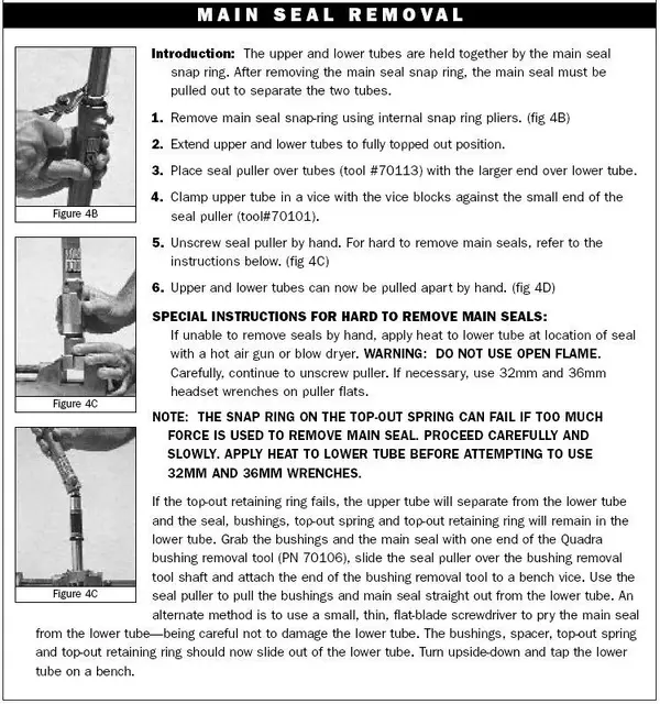

I know there's an abundance of people out there with Rock Shox service experience. So here's a simple one for you.
Removing the main seals, according to the manual, requires a tool - is this necessary or is there a way to remove them without the tool?
Also, which oil do people use when refilling them?

Nah - got the dust wipers off without a problem, also removed the main seal spring clips.... the bit I'm talking about is the next stage - steps 3 thru 6 below to be precise.
HELP... there has to be someone out there who can tell me how to seperate my upper and lower legs.... :( I wanna get shabby set of legs painted up :D
