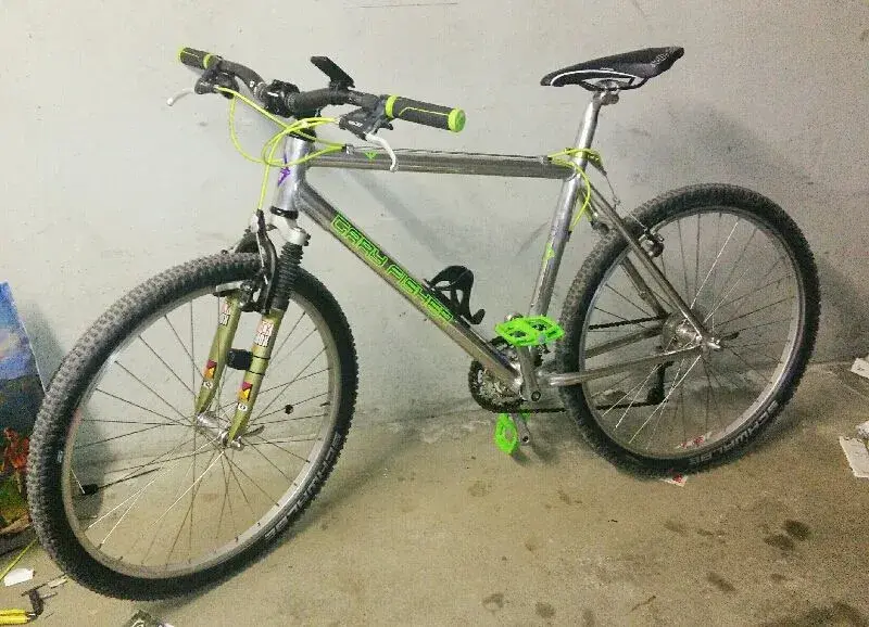

Mine looks good after 1 month, also maded with very economic bath silicone.Next time i will use the High-Temp Red RTV Silicone.
Soon i will post the photos of my Gary Fisher ! :)
