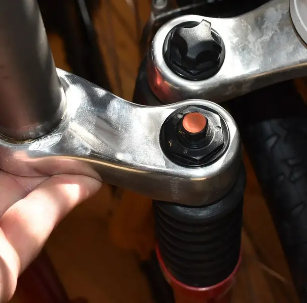

Hello everybody!
I have bought a Rock Shox Judy XC hydracoil red color suspension but I can see that missing the rebound adjuster top cap. My wife has on her yellow model.
Is anybody out there has this simple part to sell?

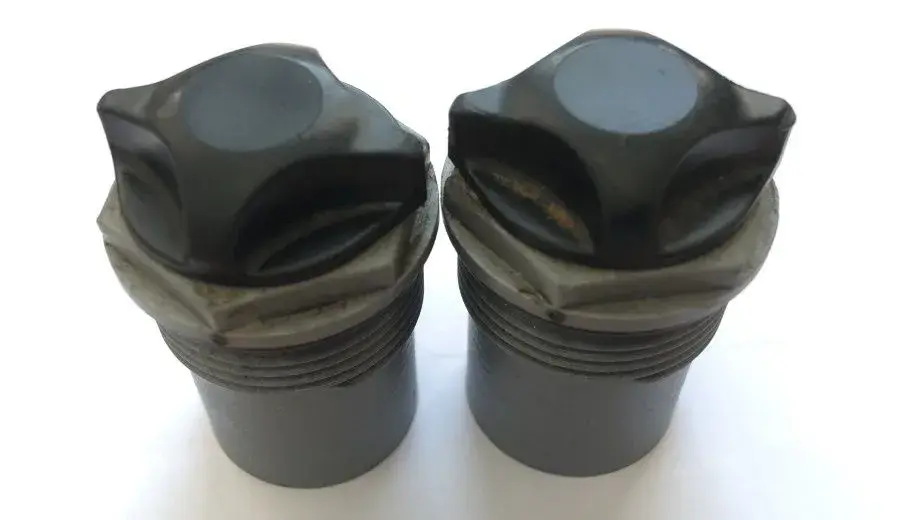

Its ready to go, it is however the whole lot so you'll need a spanner to unwind it and then screw the replacement in.
Send me your address via a PM (private message) and I'll post it to you at whatever the face value of the stamp is (shouldn't be a great deal) the part you can have for free / gratis
Nick
Here is the complete unit - they are a non serviceable item so you will need to take a spanner to the plastic nut part and gently unscrew the broken on ensuring you keep the fork up right otherwise you will loose your oil bath
then simply screw in the replacement - since mine are grey and yours are black I can send you both for the cost of a stamp on a padded envelope
so long as you have the right size spanner it will take you approx. two minutes a leg (max)

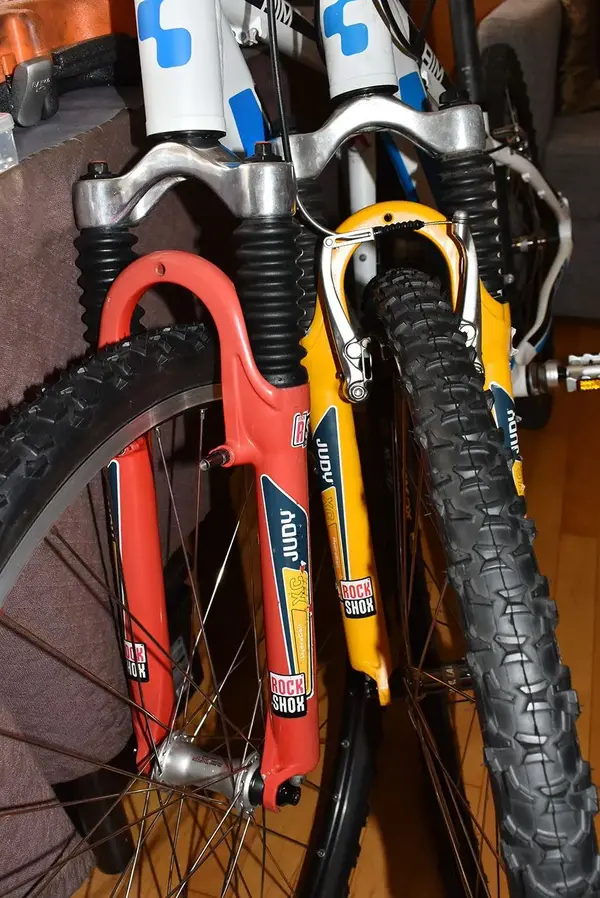

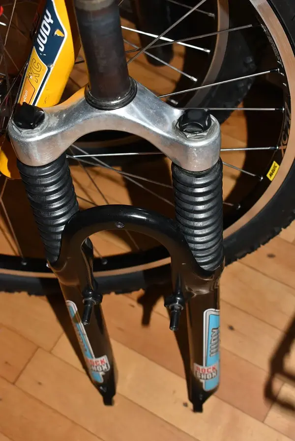

These Judy XC forks we have. The red and yellow are identical, probably year 1998? The black has the same adjuster unit like your photo, model year 2000? Your unit compatible with the red legs? Honestly I really wanted only the little black top cap not the whole unit :)
The black has 120mm, but the yellow and red has only 80mm travel.
