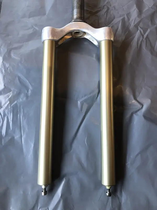

I’ll try and get them apart at some point and post pictures to gather peoples thoughts. Hopefully I can do the hydracoil upgrade.

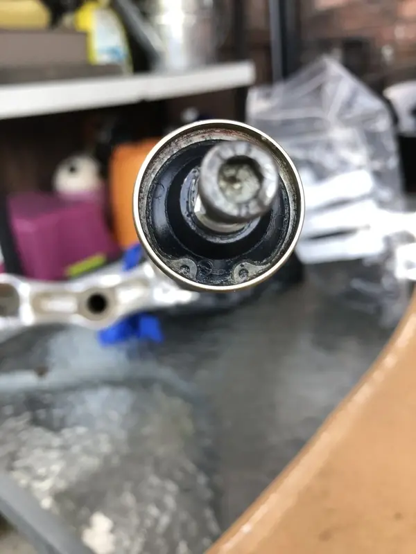

I got the lower legs off last night but need to buy a circlip tool to enable me to remove the cartridges for inspection.
The tool is the wrong one, I didn’t even realise 😩
I need a squasher not an expander.

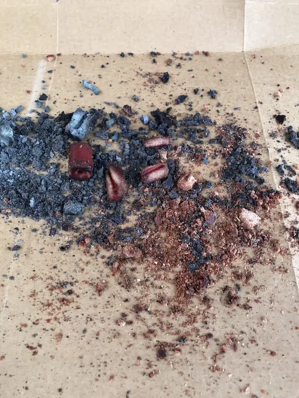

The elastomers are toast.
karma elastomers anyone? 😆
You can make that tool work but it is not easy. put it into the clip and spready the handles apart. It is not ideal but can work.
