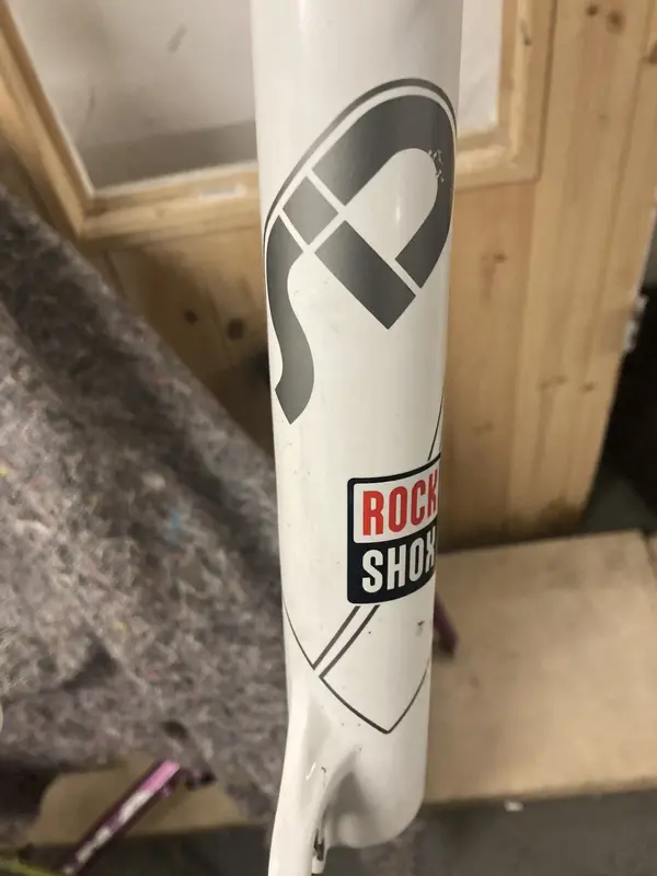

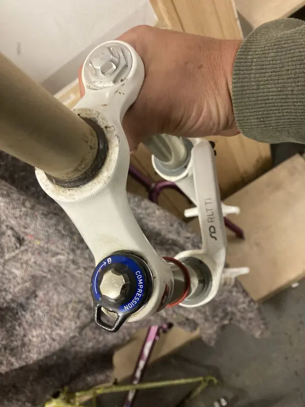

Thanks for the reply Ian. I don’t have them to hand but here’s a couple of pics from my phone
AB6CFD97-EB33-4923-BAA5-A666B46B7623.webp 1F018C11-6ED2-4ABD-AB15-0E5E01658F0E.webp 4FC860D5-EA18-4FEA-951B-E9015A810840.webp
Thanks again Ian. I'll have a ponder and keep you posted
The next generation of these forks had black wiper seals and tended to be solo air only. Don't think that this changed the lowers much, I think I built a fork for my son using a CSU from your fork era and lowers from a newer Sid. Have been riding around center parcs on them all week so far (and long before as built a couple of years ago) with no issues.
