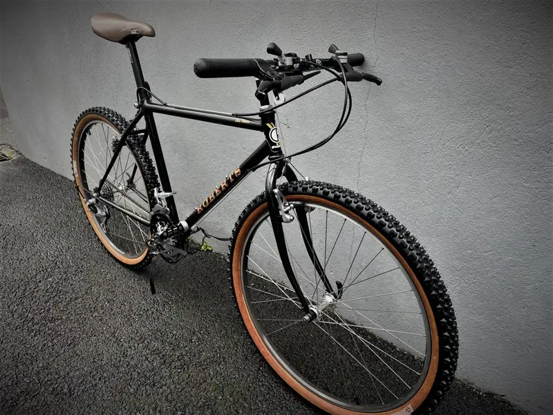

Trouble is when you are hanging it on a Roberts, it has to look right as well as work, so with no money to spend I came up with this.
And I wont lie, everything used needed some real tidying up, the wheels needed truing and hubs greasing and polishing, everything was oxidised and flat looking with no shine at all, all of it needed polishing and fettling, a mix of old Deore DX with a little XT thrown in, all polished/painted and now functioning.

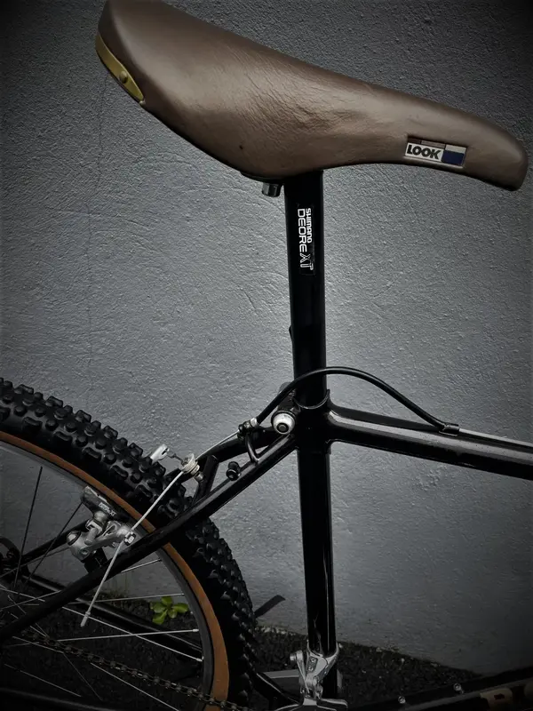

I had some usable Onza tyres, a spare pair of ODi attack grips, a rough Bontrager bar and an Odessey Stem, a really worn-out XT seat post, and I might have finally found a use for the Rolls Saddle (Labelled LOOK), that I have tried on several builds, but never quite sat right.
Anyway, aside from some rather nice 2mm cable, there's been no spend, and with only tons of spit and polish, and a box of chuck away parts, it will go again, and stay in the family with light duties making fond memories.
I wont lie, when I started I had little faith, but it turned out ok in then end, and has got to be better than any of the river bound BSOs, that could have been.

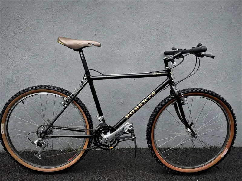

Chas Roberts XK II
(bought from the original owner, made for his size, so some small changes from the blue print to accommodate, and then stored for years)
Frame- Chas Roberts XKII
Fork- Chas Roberts XKII
Bar- Titec-Bontrager
Stem- Odessey
Headset- Shimano Deore
Seatpost- Shimano Deore XT
Saddle- Selle Italia Rolls/Look
Rims- Formula DX23 by Mavic
Hubs- Shimano Deore DX
Spokes- DT
Block/Freewheel- Shimano Deore DX
Cranks- Shimano Deore XT
Chainrings-Shimano Deore XT
Front Mech- Shimano Deore DX
Rear Mech- Shimano Deore XT
Brake Levers- Shimano Deore XT
Gear Levers- Shimano Deore DX thumbshifters
Grips- ODI Attack
Cables- Shimano Deore XT SLR/SIS
Front Brake- Shimano Deore XT
Rear brake- Shimano Deore XT
Wheel and Seatpost Q/Rs- Shimano
Tyres- Onza Porcupine.

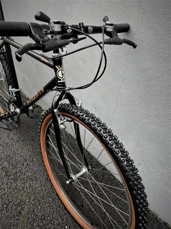

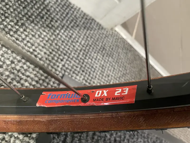

What's the story with the rims. I don't think I know them.
Cheers fellas, but honestly, it really was a cobble together, I couldn't tell you where the wheels came from, some random bike saved for parts years ago I think that I found at the back of the shed, they are double wall but no eyelets, honestly i thought they were too far gone to use, but they are ok.

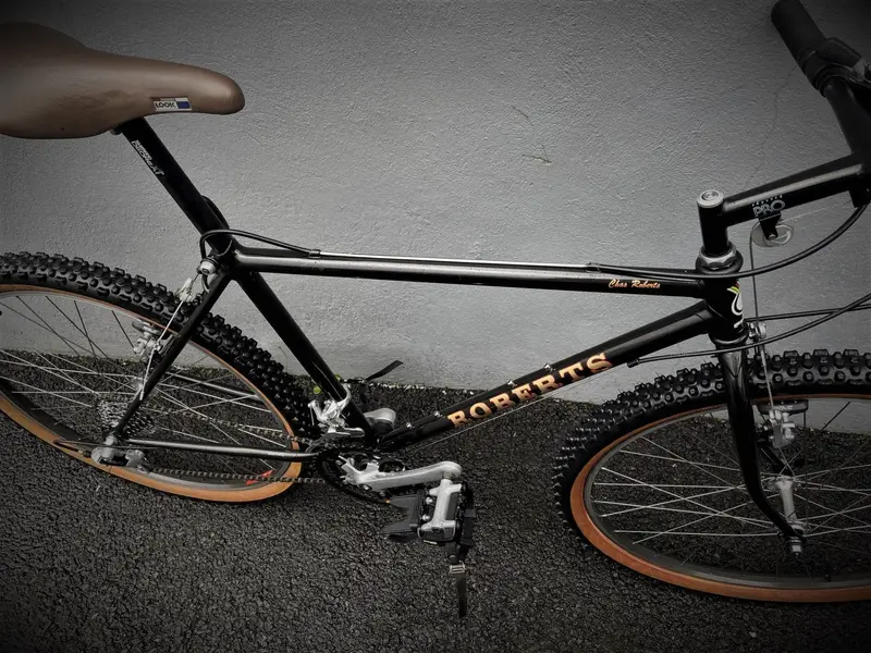

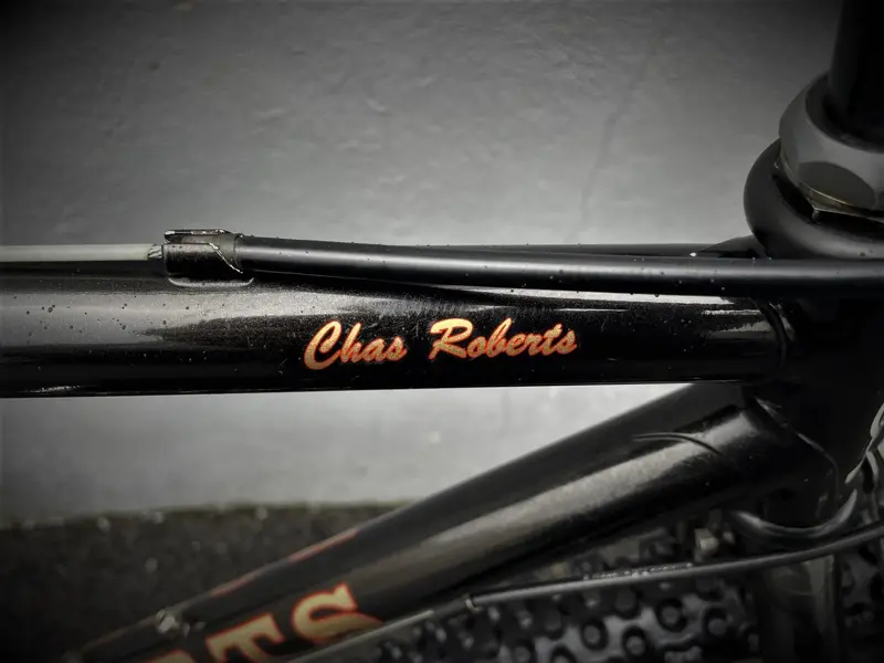

The paint on the frame was quite tidy really with only the odd touch ups needing doing, one decal is scratched which is a shame, but i have pencilled it in. Tyres were ok to go again getting a little brittle so several long sessions on the sidewalls with boot polish helped rejuvenate a tad.
I did want it to look tidy for him, he knew the Roberts Name which was nice, he automatically said "Blimey, that's far too good for my needs", Bless him.
I'm sure he will get some easy use from it, and smile because its a Roberts.
Its not Year correct or anything, from memory the frame is an 88, so the parts really are too new, but, with him as the motivation, and the interest here on another thread ref this model, it pushed me to find the time to sort out and fettle all the parts that have been laying to waste.
Surprisingly I think the Gold Lettering with the saddle colour and me working those tyres with boot polish has helped it look quite well really. thumbnail_IMG_9490.webp

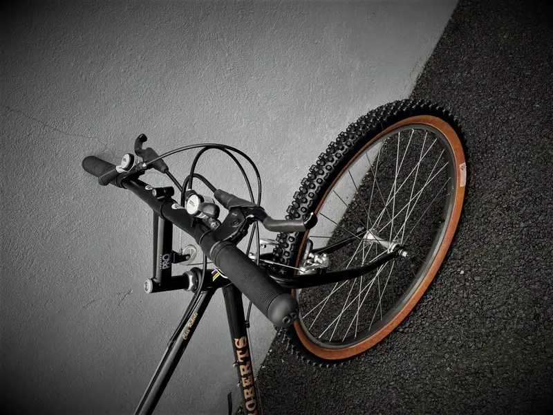

It does warrant better condition parts really, Pedals have been stripped and polished, Cages repainted, Cranks split, polished again rings painted.
The bars really need to be either refinished or replaced they are letting it down, the seat post too is really rough and now tidied up, good enough for use as long as its not going up and down, but it still locks in so it can be used.
