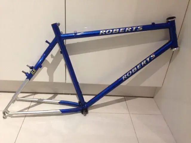

So bike is now mostly stripped down

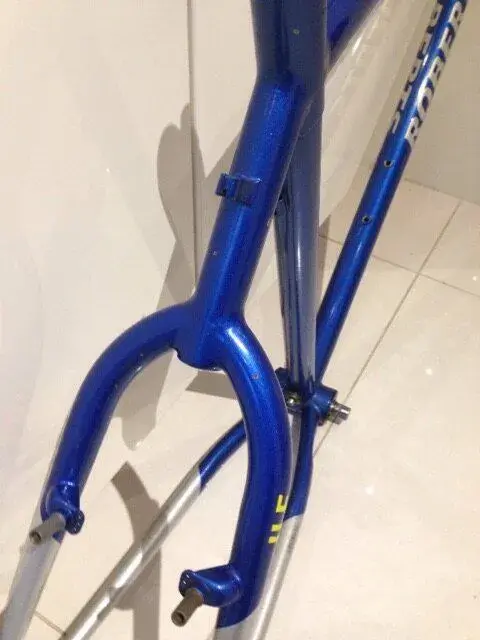

Had a good chat with the seller when I picked this one up.
He wanted a DB, went to see Chas, got measured up etc, but at 16 stone, Chas advised him that the delicate DB frame would not stand up to his heft.
So this was build to a DB design but not from Max/753, and with a one piece wishbone to take his size.
Lovely work, I have to say, and actually I think the very thin max tubes can attract dings etc, so no bad thing this is that bit more robust.
Ultimately this has stood up well.
I guess it's Nivacrom

Once the Bb is out I will give it a nice polish up, touch in the paint chips, and remove the smiley stickers fully.
After that I think I will try a m735 build, 21 speed and see how that turns out.
Frame is actually a 1995 so should really be an m737/8 and/or m900/910. I do have a mixed bag that comes too just about a bikes worth of that stuff, but I think with the 1 inch head tube, the canti bridge etc, I can go a year or two earlier with the build.
Should be fun

So new Bb tool turned up, and with my biggest spanner and a hammer I got the drive side out!
Non drive cup is not budging.
I don't want to hammer the sh17 out of it for fear of damaging the frame
Have tried the tool in the vice/turn the frame trick but again think I could damage the frame before it comes out
At least with the drive side out I can get some penetrant in there, or freeze spray or hair dryer ect, I could also probably cut it and or chisel it out
Will keep going!
