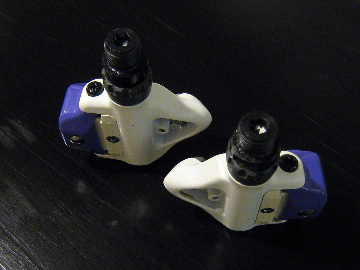

I've got the old ultgra pedals for the moutain bike cleat from the days beofre the look patent issues were resolved and whilst very neat they don't offer as much support and I get hot spots in my feeet after about 30 miles.
