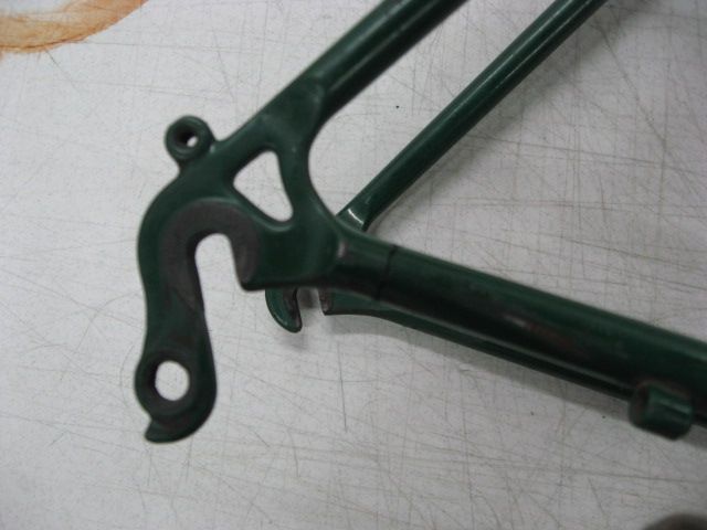

I acquire this Ritchey frame that had a broken chainstay, pretty classic failure for an old frame. So I decide it was worth it to repair it. Here is the frame when I got it.
The Crack :cry:

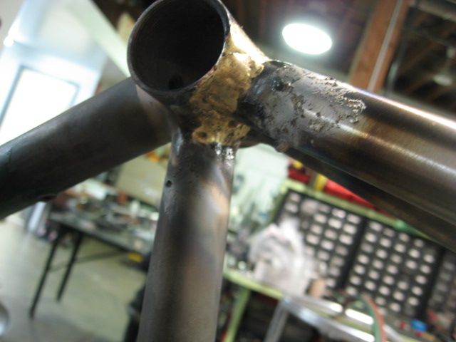

Flux it up
Heat it up and brush off as much brass as possible

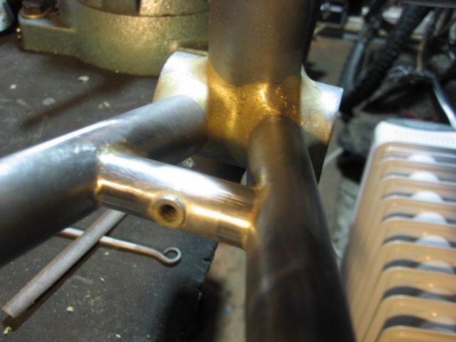

Cut the bridge

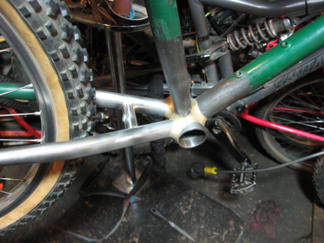

Remove old chainstay
Grind the old brass, the bb is pretty thick and the marks look deeper than they are

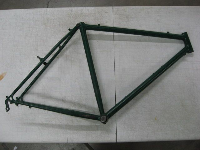

This is what it looks like now. I sold it to a good friend of mine (was too small for me) who got it painted white, He has all the parts for a period correct build, it's just taking him forever to put it together :roll:
