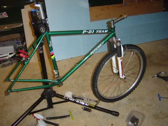

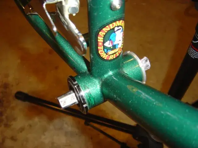

Baby steps forward....

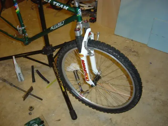

I mounted the fork in the crown tonite. It already had the brakes on it, so was a quick swap over.
I managed to find a backup fork on that auction site for about $15, so I snapped it up and consequently have spares : )
Front wheel is still true (I guess I did an ok job of lacing up that wheel) and has a nice kevlar bead Tioga Psycho on it too! : ) I have a caramel colored Ritchey Z-max in a box somewhere that might be a good one to mount on it too 8)
My parents will be in town to see their granddaughter this weekend, so I don't know that I'll get much more done in the next few days. Should be able to pick back up next week.....

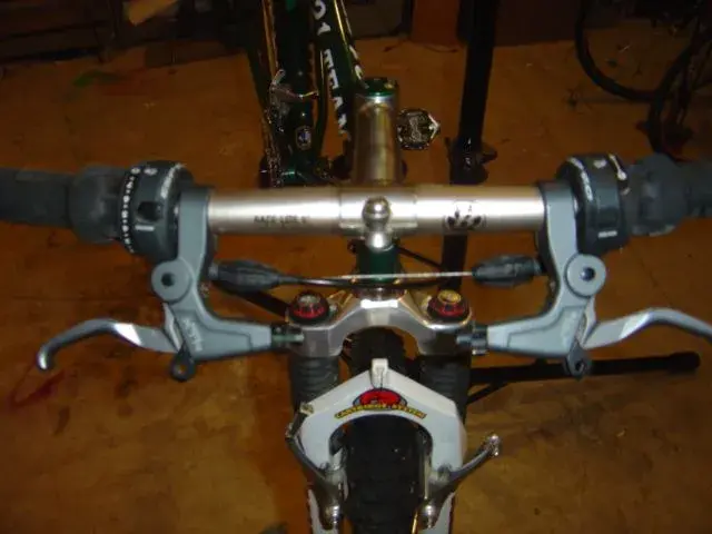

Wife decided to have a long chat with her sister, so I got some good time in on the Ritchey!
Managed to get the cockpit mounted, as well as the brakes, the bottom bracket and cranks, and finally the rear derailleur.
I really need to spend some time cleaning a few things like the chainrings, but overall, it looks pretty doggone good to me.

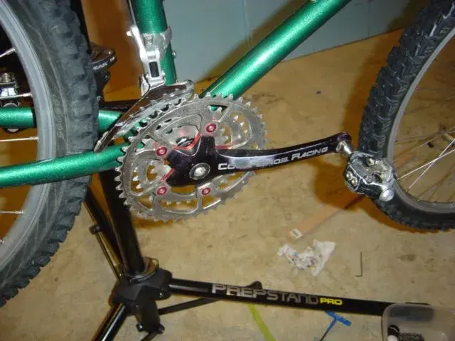

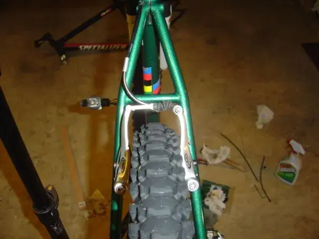

I won those Cook Bros cranks as part of a prize at a regional race I always enjoyed.... 8) Lotsa miles on them to take off that black anodizing.
On the GripShift 9.0 derail, you can see the V-brake noodle I installed. That was our shop trick to get the cables to run that curve well on a GS bike.
Sorry for the blurry pics... I did not realize they were/are that bad. Will have to re-shoot some of them...

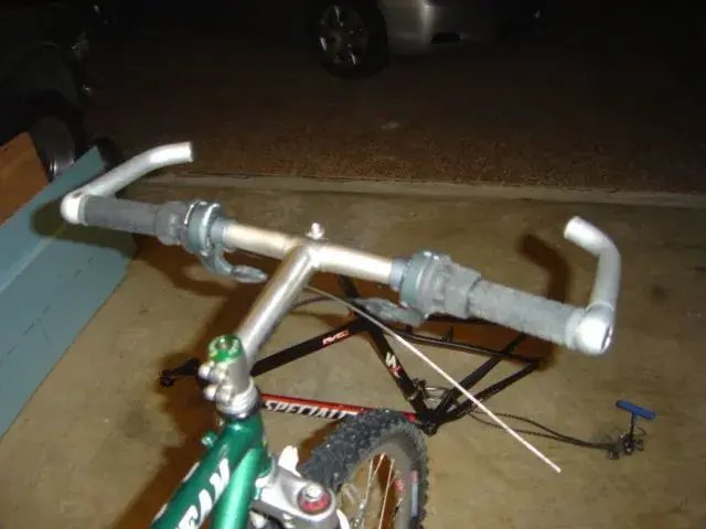

Finished the bike, rode it around the neighborhood a bit. A few more details to tighten up, but it feels just like it always did.
I hope ya'll enjoy the pics......
